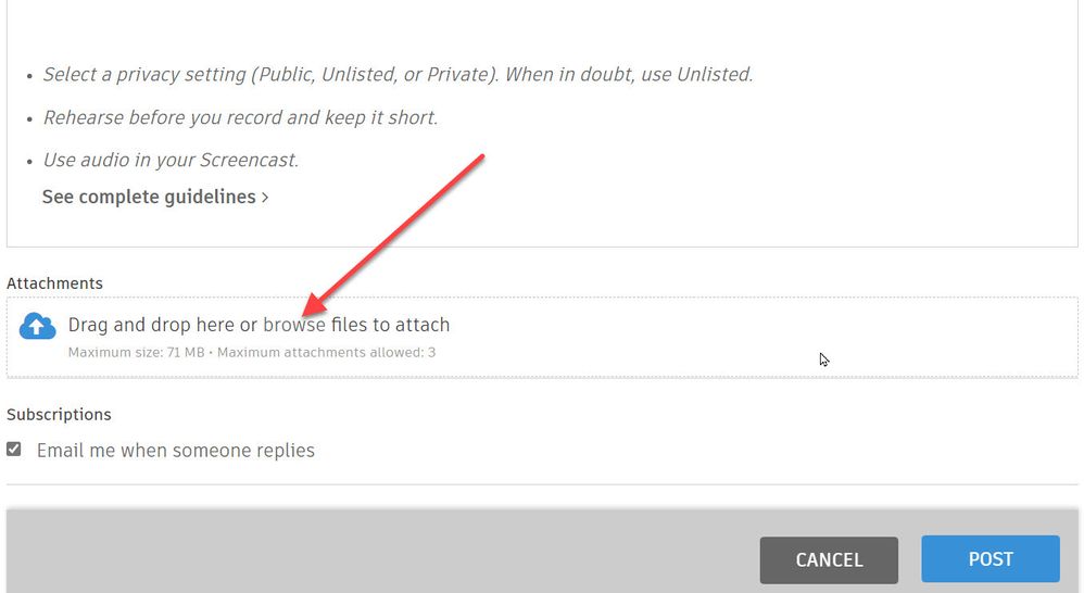

jhackney1972
Please attach your model as it is hard to diagnosis a problem purely from pictures.  If you do not know how to attach your Fusion 360 follow these easy steps. Open the model in Fusion 360, select the File menu, then Export and save to your hard drive. Then use the Attachments section of a forum post to attach it.
