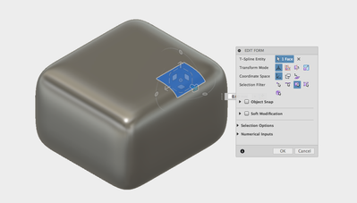

I have used the Sculpt environment multiple times but recently when I go to use it I can not see any of the segments or edges associated with the object, this makes editing it almost impossible as I can not see what I am doing. The images below will show you both the creation of a simple box and also me trying to edit the box. Notice how there are not segments or edges previewed to know how complex the geometry is. In the past, and on every screenshot or video I see of Fusion you will see thin black lines showing the placement of the t-spline grid around the object.
Any input on how to get this information to show would be great - Thanks.

Is your visual style set to "shaded with visible edges only"?
At the bottom of the screen select "Display Settings", "Visual style," "Shaded with visible edges only"
Well........I sure feel dumb. Yes that fixed it.
