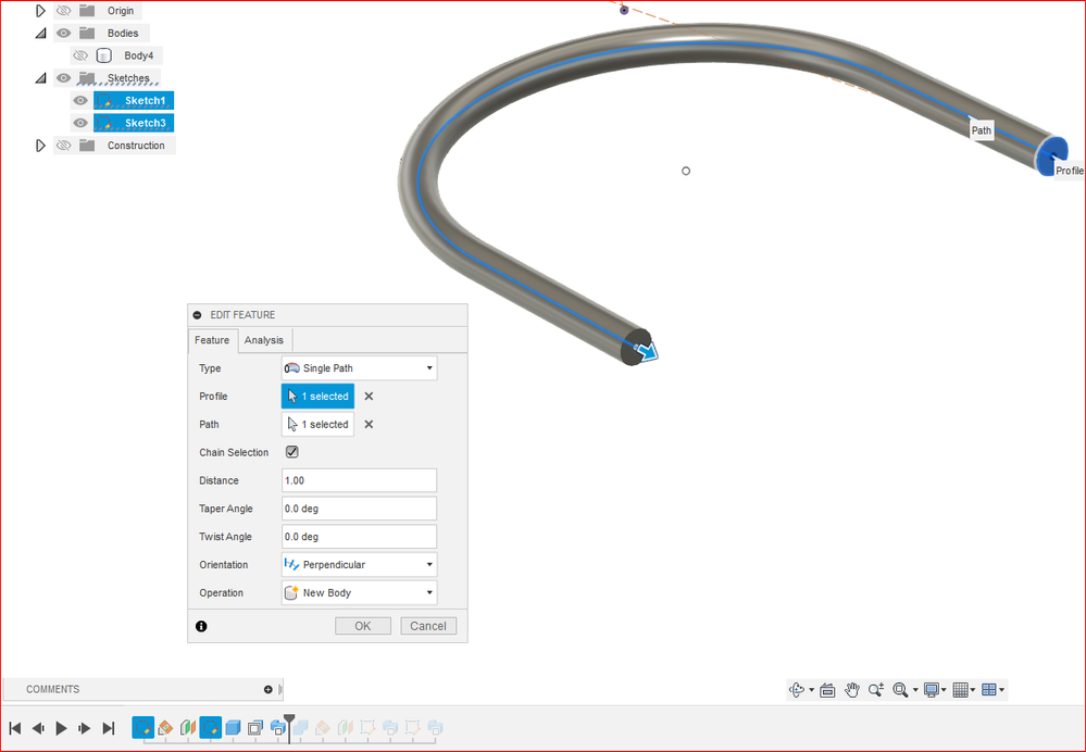

Good day folks. I’m a hobbiest using Fusion 360 to make kids toys/games for my grandkids.
 I’m trying to create a “ramp” into which a marble enters on a down slope, goes around a 90 degree turn then continues down an exit slope in the opposite direction. I’ve tried to set up two opposite planes using the “two lines” command and creating a sweep from each end to meet in the middle but without success. I’m sure there must be an easier way.
Sorry, can’t offer a model as I haven’t been able to get one to work well enough. I would be really pleased to get a solution. Sorry, just for clarity, some of my components including this one, are 3D-printed.

Path sketch - common mistake - fillets were just slightly too big.
Delete the small short line, make the two end points that are left, co-incident, and then add tangent constraint.
Because all is unconstrained (blue, orange and white articles)- anything can happen, but worked for me.
Still have to build the Sweep path by clicking on the next segment.
Might help....

andrecasselbergs
Interestingly, when I applied the tangent command to the join, the model flattened out. I went back, deleted the tangent command, redid the sweep and voila, success.
Ill try and embed this into my model.
Thanks and awful lot, been messing about with this for days . . . .

Version 3 - I can't add the tangent constraint any more.
Chasing your tail?  This example is showing why I prefer 2d sketches, your arc/s look ok, until you take a closer look.
Those white dots are the arc centre points, which don't align to anything, and the 3d tangent constraint is unavailable.  Means you get a bump / seam at the halfway point of the curve/s, considering both radii are now 38mm, why not a semi circle?
(Earlier statement, coming from both ends work around, has come into play here?)
I have noted this is a demo version, I would presume this sketch elevation
(looking slightly tilted right view and lining up both path end points as best I could)
would have been flat (stated intent constant fall - closer to view arc is the bottom one).
