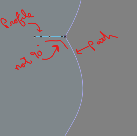

The very first problem is conceptual.  the profile is not perpendicular to the path-
the profile sweep sweep around the path maintaining the relative angle to the path it  started with.  the results are usually not what is desired.
one way to make the profile perpendicular to the path is to use "plane on path" and put the profile sketch there.
you can see this in my attached file
the next bit to realize is that when a profile sweeps around an inside curve that is to tight, the resulting shape will self intersect.  if you offset the path (I used surfaces for this. the geometry is better than when you offset a spline) you will see that the inside curves eventually just form a sharp angle.  sweep can't handle that.
interestingly, sweep can handle sharp corners in the original path.  in that case it knows to form a miter.  go figure.
anyway, the attached is kinda hacky, but have a look and see if you have questions.

Thanks for that!  I carefully followed your timeline and I think I got it.  If I summarize it in "instructions" (for myself to remember):
  1. Work on a simple corner that you'll mirror later
  2. Create a plane along the path (so you have a 90o angle plane to your path)
  3. Extrude the path
  4. Surface offset path to make a "smaller similar path inside"
  5. Create your "sweeping shape" within the 2 "walls" of inside the offset
  6. Fillet the very sharp angle so it's a curve (of the inside offset path wall)
  7. Sweep (notice the sweep will flow extended to the area of the "corner" you'll later mirror
  8. Split the surface that it's actually flowing over that area (it will create a nice sharp "slice" for the mirror later)
  9. Delete the bits flowing over the "mirror" area
  10. Mirror left, then mirror down
  11. Combine the 3 mirrors (why?)
  12. Delete bits left over
  13. Be happy.

-for the immediate problem, use the edge of the surface for the path, not the line in the sketch (either long left click to get a list of possible selections when things are on top of each other, or turn the sketch off)
in the original , I created the offset to see where the path would form a sharp angle that would foul the sweep, then put a radius on it so it would go around it smooth.  You can see the effect in th epic above, as the sweep doesn't conform to that curve on the upper part when using the inside path.  trade offs have to be made (or different tools)-
