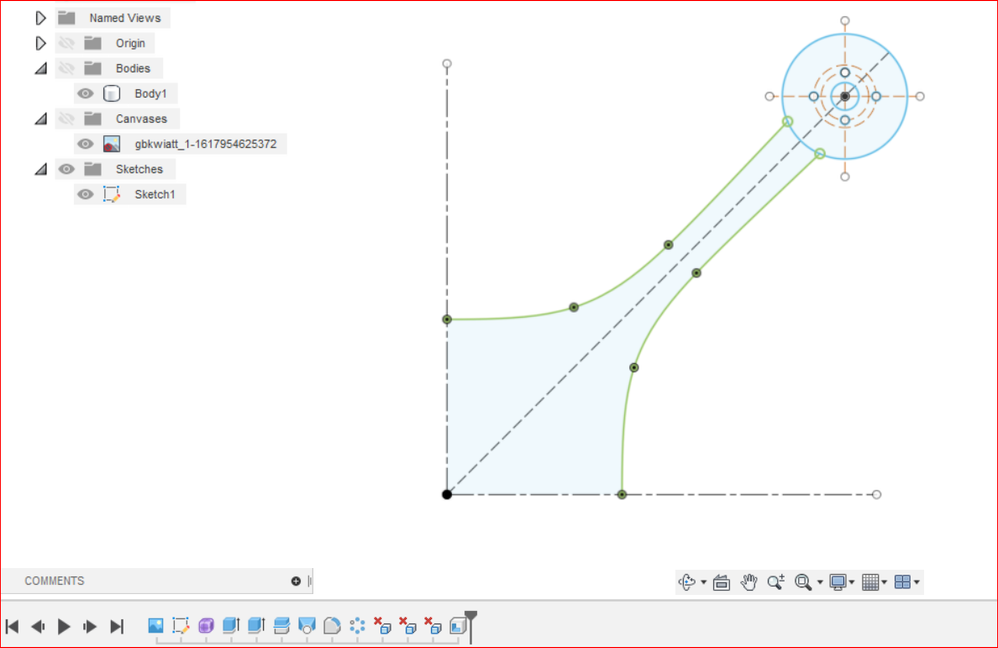

So I am trying to create drone model for myself, I am inspired by one I found somewhere online.
At first I thought it will be all simple because it's all symmetrical, but now I am stuck on extruding model from sketch.
So this is what I got
And this is where I want to go:
What would be the best approach? Of course I know nothing about blending parts together yet so it's hard for me to understand, but I bet there is some easy approach to that.
I was thinking wouldn't be better to have another rectangle on top and somehow blend it together with those curves.
How would you approach that ?

1. first create the construction for one arm only and then duplicate it
2. Please share the file.
File > export > save as f3d on local device  > attach it to the next post.

Screams out for a sculpted box with symmetry.

Yet, you have not got a fully defined sketch, and 4 times the amount of work as required, draw one arm, and later you have a 4 arm modelling circular pattern.
Might help...

davebYYPCU
Started editing and adding Dimensions.

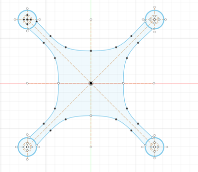

That makes sense, I am starting over again, and will do it that way. The main issue I have, well to understand "how", is that arms are tubes more less, so like thickness doesn't follow main body as such, same for motor holders.
how to make it  tube, not a "fancy" shape? and then that blends into the body ?
I got to that, slightly changed dimensions to make it more stable
Yeah and actually it might not be a "tubes" as such so it will have to be "fancy" shape 😉

so now having something like that
how would you extrude out of it ? just normal extrusion and play with shaping it ? fillers etc ?
Message 12 of 52
davebYYPCU
No, delete 3/4 of that sketch.  Add an ellipse at the fat end and a circle at the motor end of the spline curves.  Use arm splines for rails.
I was not able to close the shape with solid tools, so did it with Surface tools.
Might help....

Well, going to basics, how do you add circle or ellipse to 2d sketch?
Message 14 of 52
gbkwiatt
something like that ?
I think I've done it wrong, because it's in multiple sketches ?

Yeah, you’re right, I am not far away, need some Z height info, that has not been obvious.  Gunna be busy next couple days.  Couldn’t join the solids to the boundary Fill, so patched it.
@gbkwiatt yep, separate sketches with P for Project, circles and ellipse have to be connected.
Might help.....
