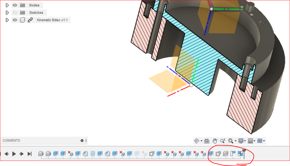

I'm sorry, I don't get what centers you mean?
Message 16 of 17
g-andresen
without words
günther
Message 17 of 17
balz.reber
Ahh, got it. I will try to correct that and then align again. Thank you so much for spotting that!
