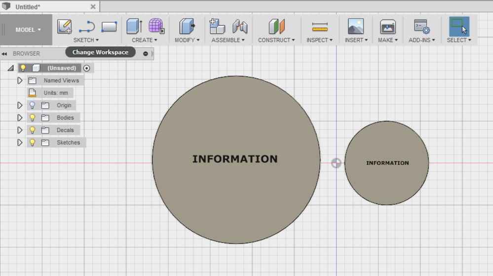

Ok, what I have done is sketch and extrude two circles. One is 50mm and the other one is 100mm, on each of the circles I have inserted the same decal. But as you see in the picture, Fusion scales decal in relation to the size of the geometry.. This means if you want to use text as decals, the chances of having the same font size across different geometry is nearly impossible, since Fusion will do it's own random scaling every time..
Or am I missing something?

Hi @Anonymous,
You are correct.  The default scale of the deal is based on the size of the face it is applied to.  Not on the scale of the image.
You can scale the image after the fact, but to your point, you can't control the scale between the two to make them consistent.
