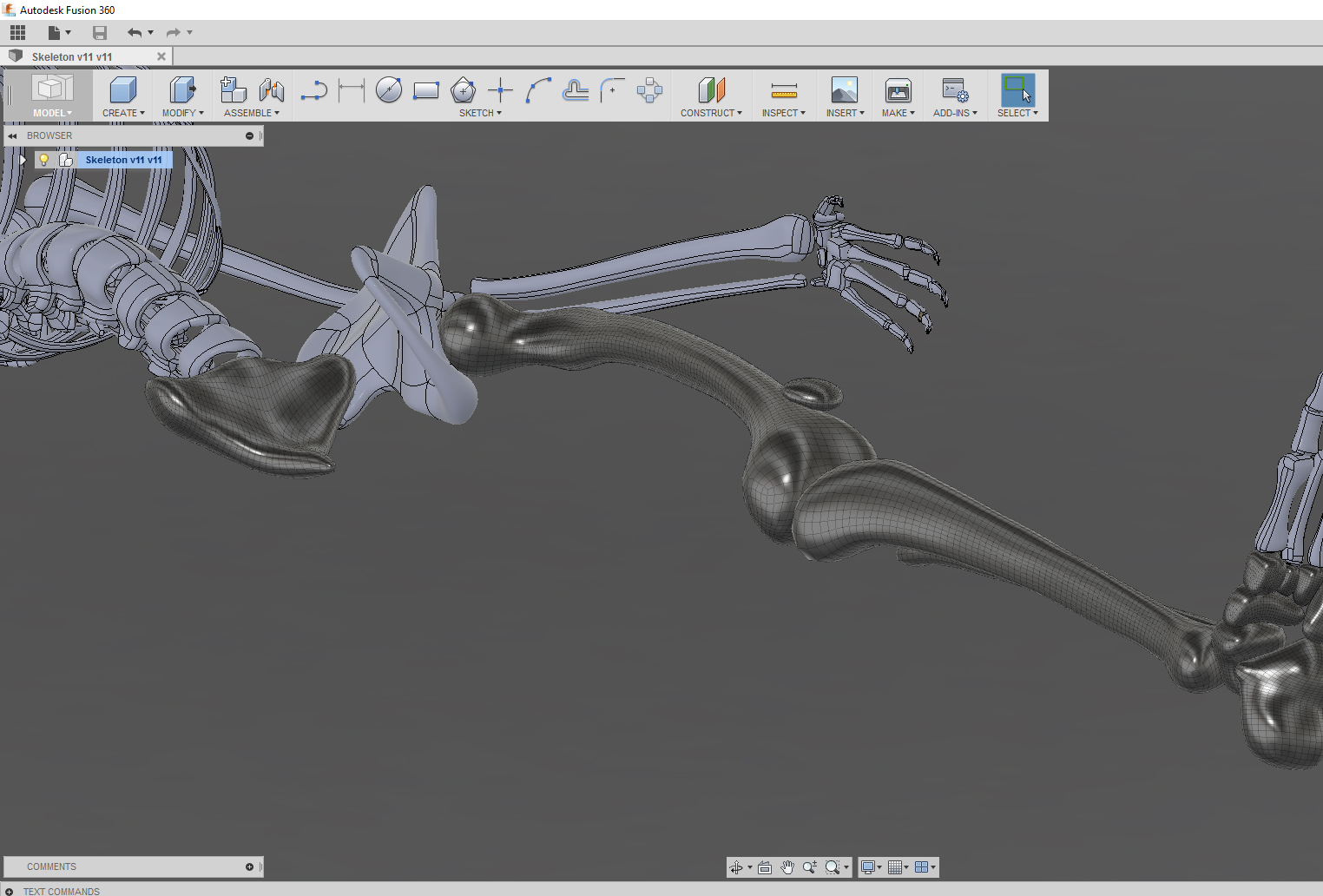

Progress:

More progress and some file reorganization.

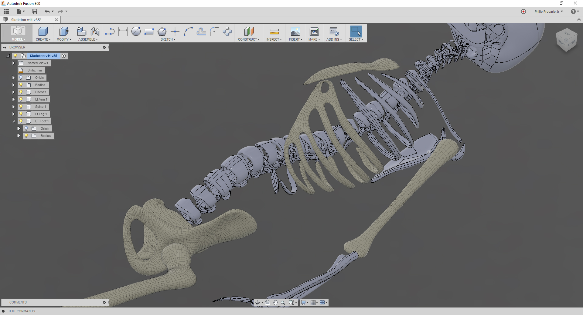

PhilProcarioJr
LLium Bone came out nice...
Phil Procario Jr.
Owner, Laser & CNC Creations

More progress:
