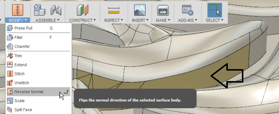

Just out of curiosity - can you get anywhere with this file as reference?  (check the surface normals)

Flipping the normals doesn't really help because fusion flips the normals when it stitches the surfaces together. I sometimes leave a couple flipped so I can see where I am working visually.
