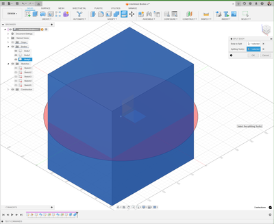

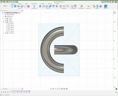

I have a body that's got two non-interfering parts. It's not possible to create a plane in between them that would avoid them both. How can I split these two parts?
Here is an oversimplified illustration. In reality this geometry are two pipes coiling around each other without touching.

Message 2 of 8
davebYYPCU
How did you make that as one body?
Where do you want to split it?
Use origin as source of any required planes.

davebYYPCU

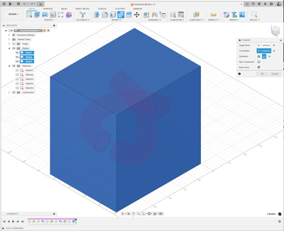

Then show in a pic the expanded Browser, and the Timeline, hide the actual bodies in the window if need be.
From here, create a Boundary Fill for each body. Hide the originals.
Might help….

Maybe you cannot easily split this "one" body, but you may be able to make an exact copy of it and replace it.
Since the two parts are not touching this might make it easier to do this. Draw a box on a plane that will enclose
the geometry.
Extrude the box and turn off the visibility of the body you want split so they are not joined.
Do a combine cut operation using the interlocked bodies as the cutting tools to create the mold.
Do a split body to cut the mold in half and access the inside.
Switch to surface and create a surface of the mold with the offset tool.
Stitch the four half surfaces together.
Use thicken to replace the surfaces with a body.
Create Components from the bodies.
Now you have two separate bodies of the original single interlocked body.
This is a very crude method but it should work. If the original bodies are two pipes then the mold should create
inside and outside dimensions of the pipes.

TrippyLighting
There are several ways to do this.
You should be able to use the boundary fill feature (surface tab -> Create->boundary fill) and create a duplicate of each object by selecting only that cell.
If the geometry is simple enough, you could also unstitch the surfaces and re-stitch them for the individual objects.
Message 8 of 8

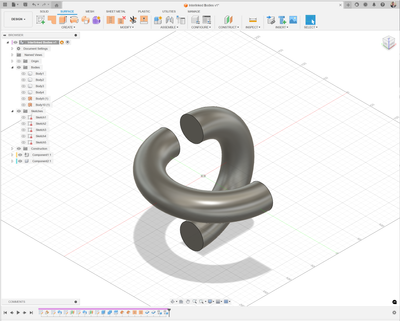

mkrsmanovic
I'm going with Boundary Fill approach as @davebYYPCU and @TrippyLighting suggested.
@Drewpan, I appreciate the suggestion. That would work for the simplified example I shared. But my case is more complex. Imagine the shape of spaghetti in a bowl, just without touching.
