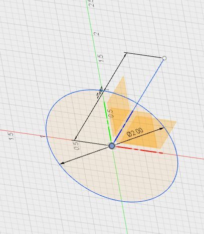

Thanks for the reply. What I'm missing is how the construction line is constrained to be perpendicular to, say, the circle.
If I create a circle on the XY plane at the origin and dimension it, it shows up black because it is fully constrained, like this.
If I then sketch a line along the Z axis and dimension it, the circle and the line turn blue (indicating not fully constrained?) like this:
It's probably very simple, but I'm confused. If I understood this then yes, I would draw the spline just as you show.
Thanks!

rohit.bapat
Hello @Anonymous
As per the requirements you mentioned, Sketch->Projection is the key (I implemented same in the file I previously attached 🙂 )
Steps are
1. Create circle and End sketch
2. New sketch
3. Select plane perpendicular to the circle plane
4. Project circle on this plane
5. Draw a line with one point on projected circle centre
6. Constraint this line w.r.t. the projection of circle (because it has become a line after projection)
3D Line Perpendicular To Circle Plane3D Line Perpendicular To Circle Plane
Please do let me know if it helps or if you have any questions.

Message 7 of 9
@rohit.bapat,
Thanks! That explains how to constrain the line perpendicular to the circle.
The one thing I still don't understand is how you drew the polygon at an arbitrary place and orientation in your first sketch. That sketch is on the XY plane but the polygon isn't. Also, the polygon isn't fully constrained in your sketch (it shows up blue).
