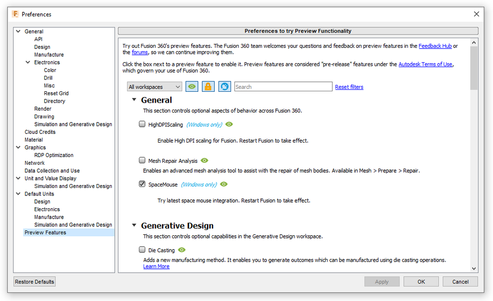

@spark__wire Yes there is an update!
I'm sorry I thought I found all the 3Dconnexion related posts about this.
For Windows* there is a new 3Dconnexion experience in Fusion 360.
  • Constrained orbit
  • Full command support for custom buttons
Here's how to enable it:
1. Install the latest 3Dconnexion drivers
2. Start Fusion, open Preferences > Preview
3. Tick Spacemouse (windows only)
4. Restart Fusion 360
For constrained orbit (Lock Horizon)
1. Open 3Dconnexion properties
2. Go to Advanced settings
3. Enable Lock Horizon**
* macOS support is in development
** known issue: currently, changing the view cube "up" direction will not set a new horizon for Lock Horizon
Let us know how you like it!
