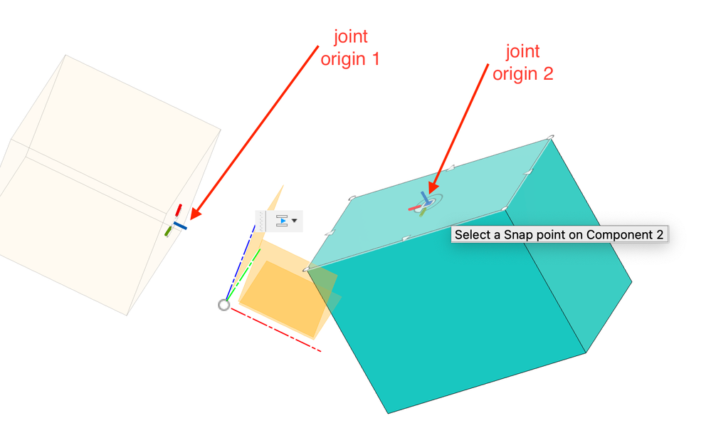

joint axes are determined by the geometry selected, and generally have nothing to do with the global or component origins.  A joint is composed of two joint origins.  You can see a preview of these when constructing a new joint:
The joint origins are always positioned so that the Z axis points away from the geometry selected.  Hint:  coordinate systems in Fusion are always displayed as:
  • red: X axis
  • green: Y axis
  • blue: Z axis
as you can see in the image, the Z axes of each component are oriented away from the selected geometry.
When a joint such as a slider is created, the default is to use the Z axis as the slider axis.  This can be at any angle, depending on the joint origin.  As you can see in the video below, you can have a slider axis that is at any arbitrary angle with respect to the global or component origins.  Hope this makes things clearer.
