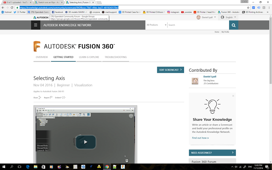

As you suggested I made Screencast, it's http://autode.sk/2eNJ8LI Message down below tells me that this HTML is invalid; this is what I got: I tried it and it works.Might ge another subject for the Forum. Thank you Phil.

@Anonymous you post the address highlighted as the screencast url in the pick
