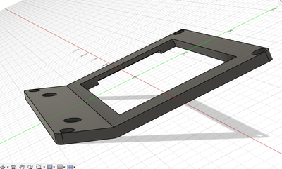

I'm trying to sketch at an angle but running into issues where different sketch elements aren't on the same plane despite my efforts to make them so. I tried using the angled body surface to create a construction plane, but as you can see in the image some of the sketch is floating above it and since its at an angle its not a simple changing of the z position.
I want the sketch plane to be exactly on the surface of my body so that when I extrude downwards there isn't any shapes sticking out of the top.
How can I make sure my sketches are where I want them to be? Do I have to eye it?

The file you attached will not open with the following message.  Please try and attach it again.  Normally what you need to do is create an Offset Plane from the angled face with a zero offset.  Need your model to verify.

Your sketch was not created on the sketch plane.  If you select your sketch and right click, you will see this in the context menu.  You will have to remove some dimensions to other features to allow it to move back.

Hi! I took a quick look at this design. The first thing I notice is that some geometry on the "nut cubbies 1" Sketch seems to be on a different plane. I suspect the geometry was created with 3D Sketch option enabled. If the geometry should be on the same plane, I suggest you delete it and disable 3D Sketch option. Then recreate it.
