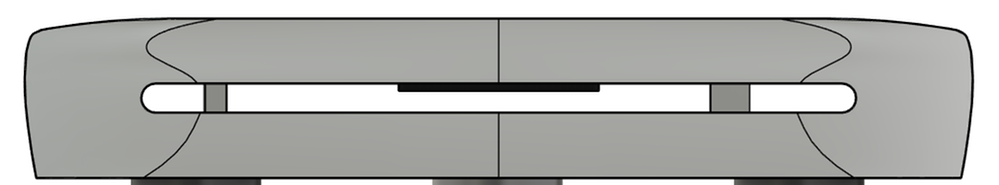

Hello, I'm trying to create a second plate that needs to follow the exact curve on the side as the front plate, to do so I created a sketch plane on the back of the frontplate, projected the curve along the side and shaped the inside to my needed dimensions, but no matter what I do when zooming in the edge always seems to be out of line.
When zooming in the Sketch shows for whatever reason the sketch is offset from the original edge, I am choosing each edge to project one by one not selecting the entire body so I assume its not the front edge being projected
I dont this could be some sort of anti aliasing polygon loading thing becuase I took this model into Blender to render and found the weird uneven gap there so I want to make sure it isnt like that at all as this product will be made in real life

I was able to create a new front plate that is inline with everything but I have a new problem, The S edges down the sides of the front plate of the new model stick out and create an unwanted design, I attempted to fillet the edges but this resulted in deep unnatural cuts and I am unable to delete any face or combination of faces to remove the linesimage.pngimage.pngimage1.pngimage4.png
I need the flaceplate to be smooth is there any tips or tricks to remove this?

I’m running into a frustrating issue with a faceplate design in Fusion 360 and would really appreciate some advice.image.png
The problem: I’m getting visible surface artifacts (a seam or shading line) on the top face of a faceplate, where it should be completely smooth.
Here's the setup:
  • The faceplate is built as a solid component, created by extruding and combining the side and top plates.
  • To apply the front curve, I used a Loft Cut taken from the negative space of an imported OBJ reference mesh. The front curve is quite complex and couldn't be accurately recreated with sketches or dimensions.
  • As a result of this cut, unintended S-shaped curves formed along the sides — these weren’t intentional, just an artifact of how the loft followed the surface.
  • The unrendered view (third image) looks fine, but when lighting is applied (first and second image), a visible edge or seam shows up on the top surface, disrupting the smooth appearance I need.
I’ve tried fillets and chamfers, but they only made the issue worse. I’m looking for a smooth, clean surface for both rendering and production use.

Hi! Without seeing the actual design, I can only speculate. I think there is probably a tiny gap between the projected edges and the actual edges. If you delete the projected edges, does the profile still remains closed? You may consider using Push & Pull or create a zero-distance offset surface and extend the surface, instead of extruding the profile.
