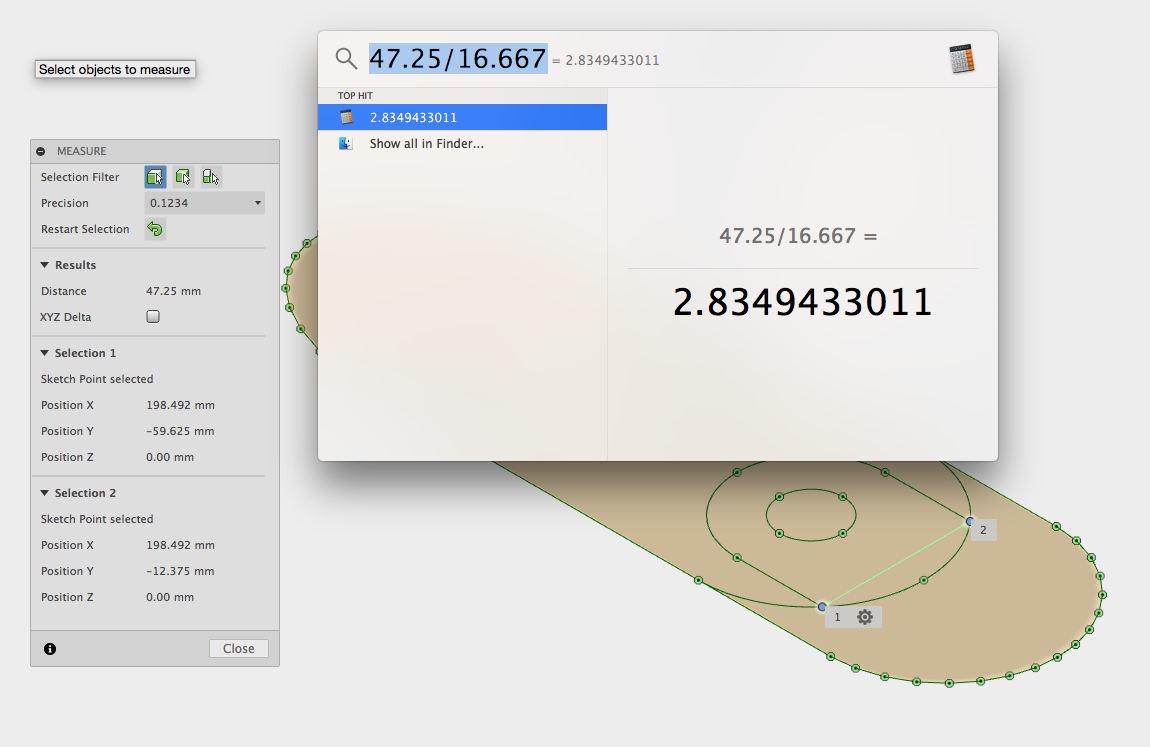

however it is true that there seems to be a scale factor at work sadly

SVGs imported into Fusion have a scale factor they should be loaded as 1:1.
when you have svgs then using images as canvases is not very good
