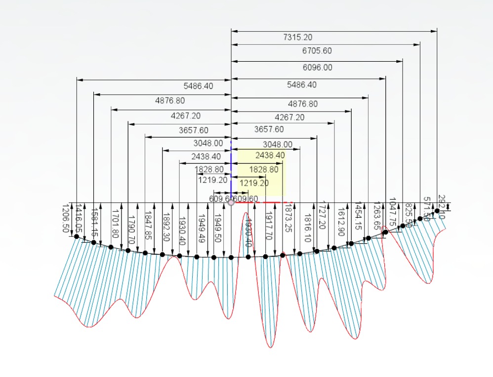

I took the sketch with the spline and re-created it with out the end points as they are projected from somewhere else and don't carry dimension. It does not matter for what the image below demonstrates.
Whatever method you use to create a surface, if you use this spline to create the surface, the curvature of that surface will be the same terrible quality as shown in the image. It matters not if that curve was created by mathematical means and then is imported per script. Unless the method that creates the spline also uses a 5-degree multi span spline and the imported points are exactly the spline fit points then the curvature is going to be terrible. There's no way around the math here.
The actual surface quality might in the end of no concern for a manually manufactured boat, however you'll have to get to that point first. These curved surfaces, are often just the basis for further work and they might be trimmed etc. With such curvature these trimming operation will create broken edges and that in itself might prevent a project form completion.
@Fully_Defined I agree, this is a cool project.!
All of the values you see were recorded by a man with a tape measure in 1909, and there's a lot more where that came from. Of course they're off! The whole point of all of this is to fair the lines so they are graceful and more hydrodynamic. I have to start with a skeleton that I can then alter, and all of this madness with repeatedly entering identical values just to avoid having sketches with 10,000 purple lines with relations I can't see is starting to make me rethink using Fusion 360 for this project.
That leads me to why I hate going on forums. While I believe all of you have your hearts in the right place, you make far too many assumptions about people like me who go on places like this to engage in technical discussions. I always end up with people trying to convince me I don't know what I'm talking about. Smarter people than me might take that as a hint, but I'm too stubborn!

@TrippyLighting I don't know if vintagerider will alter his design, but he will alter arguments, for sure.
@Fully_Defined It doesn't matter if measurements were made in 1909 with a tape. In 1909 they've expressed they intent directly in a model, and sections were drawn off of it.
You are in a different position, using MCAD type of software we expressing intent with sketches, but those old sections drawings are useless since they weren't used to define the shape.
Hull is a very specific "organic" shape and with few exceptions, it's almost impossible to imagine shape through sections, relations between sections are to complex for humans perception.
Even simple surface modeling is not enough (in most cases), to define a complex shape.

"How about a wooden sailing yacht though? I want to have at least 60 planes, and have hundreds (HUNDREDS!) of points at predetermined coordinates, with two of the points' axes COINCIDENT WITH PLANES. Each of these points become coincident to spline fit points, and this spline then feeds an intersection curve. Multiply that several times and it starts to fill up with superfluous purple lines and repetitive clicking, and it starts to get pretty ugly on screen.
In order to do accomplish my mission in Fusion, I added parameters that match the distances from the origin that the planes would have existed at, and then used that parameter as the dimension when placing the points. It allowed me to get some consistency without seeing red dots everywhere even when the sketch isn't open. But it's a workaround, and not ideal."
@Fully_Defined is not in a position to judge, his points are mere speculations.
