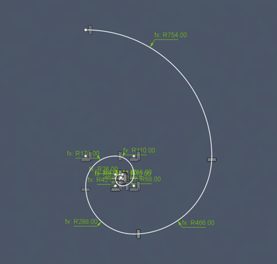

Hello 360 community! I accidently posted this issue in the wrong forum section the other day and another community member was nice enough to direct me here.
I am trying to create an adjustable model based off of a Fibonacci spiral. I drew up a quick sketch of a Fibonacci spiral, tested it to make sure that it was constrained and adjustable and everything seemed to work as expected. When I started building it again I cannot seem to get all of my arcs to work correctly.
The model is fully constrained as it should be, but when I adjust my initial square’s size (which I built the sketch off of) Fusion errors and tells me to check pretty much everything in the model.
After some deleting to try and pinpoint the issue, I believe I have narrowed it down to some Arcs causing the problem.
It’s strange because some arcs work and some do not. I have uploaded the model to demonstrate.
To replicate the issue, adjust d1 (found on the smallest square next to the origin point) notice how the model adjusts, then add an arc (I used 3 point arcs) into one of the empty squares to try and add to the spiral. Then after drawing the arc try adjusting d1 again. Instead of adjusting as it should (like the other squares with arcs) it seems to break the render and cause fusion 360 to fail at the computation.
As you can see the arcs SHOULD also adjust accordingly. The empty squares should allow similar arcs but if I add arcs to those squares the arcs ARE constrained but they prevent d1 from being adjusted.
I tried using a fit point spline instead of arcs but the spline does not stay within the squares, and sometimes doesn’t seem to render properly and I need the model to be precise.
Does anyone have any creative advice on how I can build this properly? Or on why I cannot seem to add arcs to the squares in question without the arc causing resizing problems later on down the road?

I had similar issues when I created a sketch that had a bunch of cascaded dimensions.  When I would change a user defined parameter the calculations would bomb because everything was referenced to something that had to be pre-calculated.  I recreated the sketch so that all of the dimensions are from the origin and it worked fine.
The other issue here is that the sketch is effectively overconstrained.  I deleted all of the dimensions and then added the minimum number necessary to get the drawing fully constrained.    This was an interesting process because some of the construction lines get the constraint from the tangent and some from the reference frame dimensions.
I've attached that version so you can see how it works by just changing the single user parameter.

I mean, it could be that your just overloading the sketch solver.  a few things to implement-
-you don't need the diagonals, just more stuff for the solver to deal with.
-use individual lines instead of the square tool, and then avoid laying multiple lines on top of each other.
-you only really need the one dimension, do the rest with constraints.

@TrippyLighting
What kind of sorcery is that!
That is pretty creative... so you drew a 3 point arc... constrained one of the end points to the origin, then put a horizontal constraint between the point of the arc not attached to the arc line and the point of the arc line not currently attached to anything in order to constrain it 90 degrees... then used the arc radius as your sketch dimension and when creating a new arc you add the length of the previous two arc radius sketch dimensions.
Hum...
Because of its constraints you can even select the entire sketch, copy it, complete the current sketch, create a new sketch, paste it into the new sketch and constrain the first ark to the origin point of the new sketch and everything automatically locks into place and the sketch becomes fully constrained.
Very, Very CLEAN. Hum...
Now that I think about it... what types of arcs did you use in your sketch? It appears to work for both 3-Point and Center Point Arcs. Do you remember what type you used? Do you prefer one type over another?
So far this might be my favorite solution as I should be able to go back into my original sketch, delete all the lines, constrain everything, and be good to go...

Hey guys,
@TheCADWhisperer I do not think a coil would work unfortunately. I would like it to be flat for a more 2d-ish artistic project I am planning to 3d print.
I loved seeing all of the ways some of the wonderful people in the community showed how they would build a Fibonacci spiral. Seeing multiple creative ways to solve a problem from many different points of view gives me lots of joy for some odd reason.
So thank you @brink.gregory @etfrench @laughingcreek @TrippyLighting @TheCADWhisperer for all of your wonderful suggestions.
I chose to model my spiral off of @TrippyLighting. I really liked the simplistic design and I was able to go back into my project and easily apply it, which was a bonus.
Does anyone have any advice on how I can divide the spiral into sections, while still maintaining the ability to adjust the size of the spiral?
I am going to 3D print the spiral in multiple pieces and so I created an offset of the spiral, drew lines, added coincident constraints to lock the lines onto those offsets, and then constrained each line to the origin, and then drew a construction line down from the origin to use as a reference when applying degree/angle sketch dimensions to each line and then split the spiral into separate parts every 15 degrees.
The problem is that resizing the spiral is an issue… I think that the sectional lines are moving and adjusting as they should when resizing BUT they end up adjusting to where the arc line ends and since the sectional lines are constrained to that arc line, they do not really know what to do when they reach the end of the arc line, and understandably don’t know that I want them to simply expand into the next arc line.
I tried using a spline to have one singular line to constrain all of the lines to but I could not really figure out how to make it work.
I cannot just draw lines over the spiral either… I need to be able to have the spiral in sections. How would you go about dividing it while still being able to adjust its size if you need to?
