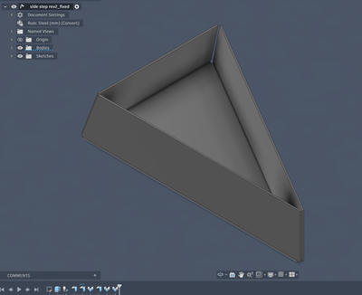

I assume you don't mean like this?
Can you elaborate?

brianW8BLZ
no  I need the one flange bent to 111 deg. and the other 2 to 90 deg.

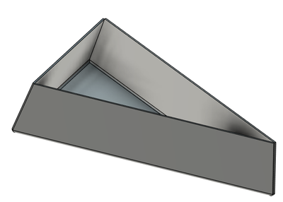

brianW8BLZ
here is what I am taliking about the 2 side are bent to 90 deg. and the front to 111 deg. the one corner has all of the interference that i cannot solve

Warmingup1953
Updated sides

brianW8BLZ
this is correct  That is crazy how you achieved it

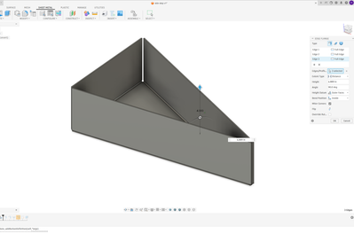

johnsonshiue
Hi! It is true that there isn't an exact SWX-like workflow in Fusion in this case at the moment. However, it isn't too difficult to create individual Flanges with asymmetric offsets. Then use Corner Closure to heal the gap. There is no need to use Surface Modeling workflows here. Please take a look at the attached f3d file.
Many thanks!

brianW8BLZ
how did you do the 3rd edge flange, not the entire way of the material?

Warmingup1953
Thanks for that.....I must have missed the arrival of corner closure...This is a great help!
A link to the Brad Tallis video that explains it very well.
Corner Closure

johnsonshiue
Hi Brian,
You will need to select a width option allowing the Flange to run partially on the selected edge.
Many thanks!
