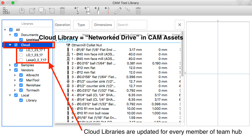

Thanks for the response! Because Fusion allows for the use of Cloud tool libraries, only those libraries are updated for all members of a team hub - this is because the Assets folders are shared across the entire teams hub (via the cloud).
When working in Fusion in a Team Hub, think of the "Cloud" section of the Tool Library as your networked drive (and the folder you added for it) in HSM. Instead of being linked through your networked drive, the tool libraries in Fusion are shared through the CAM Assets folders for the team hub.
Folders/libraries added under the "Cloud" parent folder are linked to the CAM Assets for the entire team hub - so if you edit a tool in one of these libraries in Fusion, the changes will be updated in every member of the team hubs cloud library when they refresh their CAM Tool Assets folder in the Data Panel or reopen Fusion 360 (they will see a new version of the Tool Library in the Data Panel when a team member makes changes).
Using the "Import Library" command described in my last post should allow you to add a locally saved library from your computer to a cloud library, which will share it to all members of the hub. To then ensure updates are pushed to every member of the team hub you will need to make any edits to the cloud tool library within the Tool Manager in Fusion.
