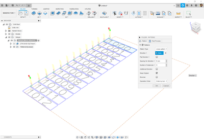

Is there anyway to sketch sequential numbers in a fusion sketch.
I have to engrave 6000 keys with individual sequential serial numbers .I was hoping to generate a engraving program from a sketch but have no idea how to do this quickly .Really don’t want to type 6000 different serial numbers using the text command
I will be using a Roland EGX 350 engraving machine but also have access to a CNC milling machine
Any help much appreciated

I would recommend using Excel or Google Sheets to create a column of your sequential numbers (using a formula).
You can then copy the results into the clipboard and then paste them into a text field in your Fusion 360 sketch.
In Manufacture, you could create your trace and profile toolpaths, then just pattern the profile toolpath.
Hope this works for you.
