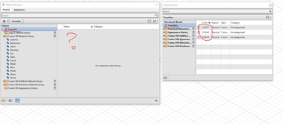

Hello Fusion world 🙂
I am a new user of Fusion 360, downloaded a trial version and want to model and analyse simple structure. I have 2 materials in my scheme: concrete and steel. There are lot of steel materials in fusion library available but no concrete.
I have found some concretes in asset broweser but I am not able to add them to my model. Is it a trial version limitation or I am doing something wrong?

Jummybear
I cant add concrete to created new library, I can add it only to favourites. But it doesnt appear in favpourites material browser...
What is the difference between material browser and asset browser? The problem seems to be there, I cant move anything from asset browser to material browser, and in material browser I dont have any concretes...
I have made a step-by-step sketch, discribing my issue. Step number 7, adding materials to material browser is not possible here...

Jummybear
Can you show it on screenshot? I have added to favourites, and then nothing. Made it active, but cant add anywere, see attached picture.
