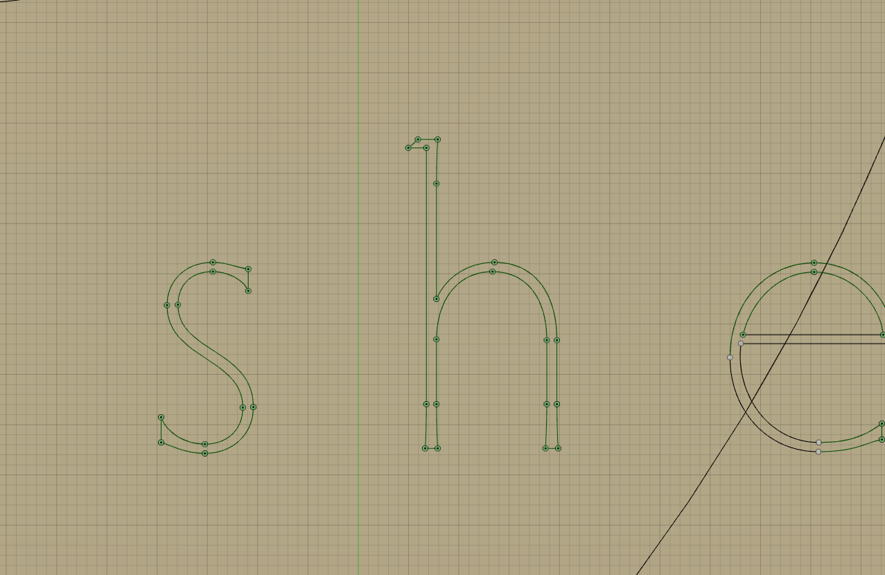

I am waking this from the dead because I am having the problem where if I window select a bunch of geometry, small entities are ignored.  I'm on a mac too, a late 2013 MacBook Pro, decent machine.  The sketch I am fighting with is relatively complex as it is my company logo.  Someone else looked at this same file and didn't have the issue.
Before the window select, notice the s and h are all green..before selection.png
ater the window selection, notice the part of the h at the top that is still green.after selection.png
Anybody else seen this?  Anything I can provide to help investigate?  Turning on "select through" fixed the issue for me too, but I scratched my head for quite some time figuring that out.  Doesn't make sense as I am not selecting through anything.  May be some sort of tolerance thing.
Message 11 of 11
NicolasXu
Hi Paul,
Thanks for reaching out. I can reproduce the issue. It looks like to be related to the level of zoom in. The closer the geometries display, the less the geometries get ignored. I have asked the development team to look into it and see how we can improve this. (Tracking ID is FUS-16994).
