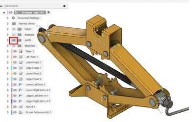

Selecting joint icons to hide them is quite tedious. Is there a quicker way? I would love to have a keyboard toggle set to filter joints (or any other element).  Like we use the keys 1, 2, 3 (window, paint, freeform) for the selection styles.
See demo video. FYI I am using the V key to hide the joints

Why not simply click on the eyeball in front of the Joint Folder?
or
for specific Joints
expand the folder and Shift or CTRL select (I assume there is a similar CMD technique on Mac.
I feel like I must be missing something.

If you have an assembly with multiple linked subassemblies, or you work a lot with explicit joint origins, also in nested in linked components, then having a global on/off toggle  definitely helps.

Thanks for bringing that "object visibility" setting to my attention. I did not know about that. It would work except there's one important joint that I need visible to control these multi axis hinges. See video demo.
I think I also just need to be more vigilant about hiding the joints in the assemblies and subassemblies and xrefs.

Create a hinge with all joints including the limits of motion, make the symbols invisible, save it as an assembly and insert it into current design.
