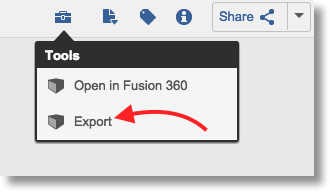

Once the web page loads click the toolbox icon and select export. It will default to F3Z. I like to put in the comments a short explanation of what i'm doing.

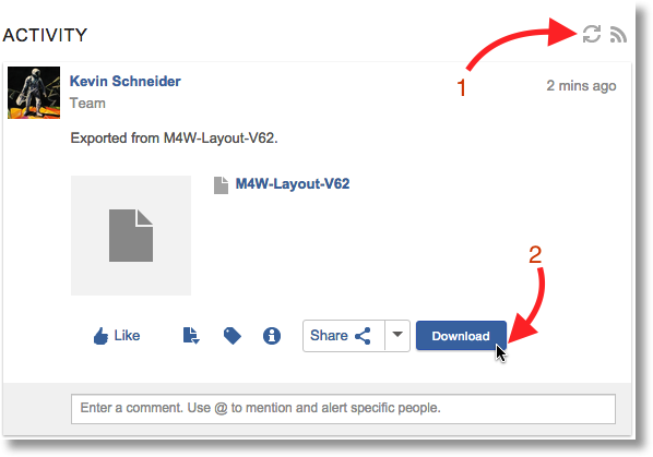

A blue button will appear saying 1 new post. If you refresh you can see the activity feed will have an event where you can download the results of the cloud translation. The download will be an F3Z file. Save it to your desktop or another convenient place.
