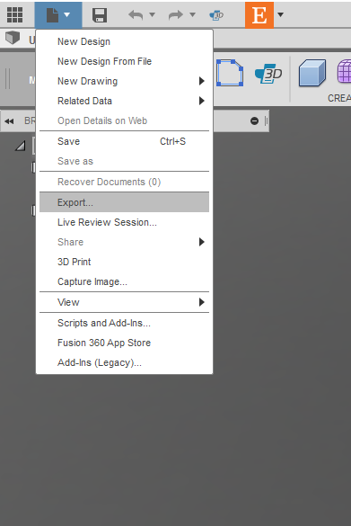

Go to File -> Export and save as a .F3D Archive File
Then in the save to my computer part click on the 3 dots and navigate to where you want it to save to.
This is the way to do it there is no save too any places you want other than a cloud folder at this time, Fusion is a cloud productSmiley LOL
