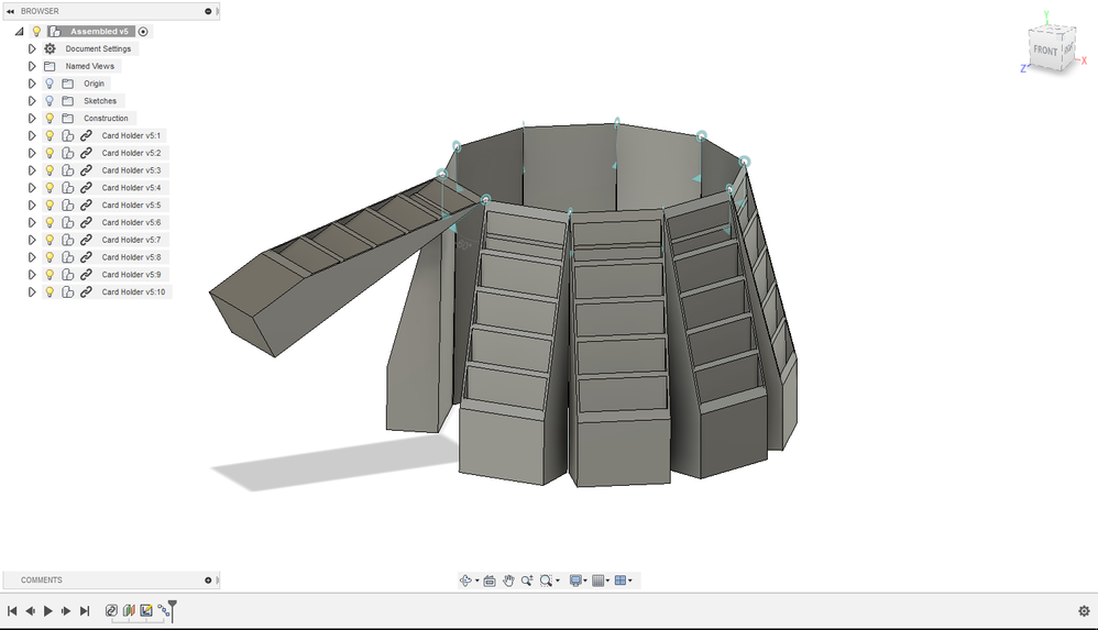

Rotate multiple joints simultaneously
Model:  https://a360.co/2Dq8E5O
I'm trying to make it so all the components move at the same time.  I've tried to do a motion link and that works, but it is only between two at a time?  I suppose I could daisy chain them all, but that doesn't seem ideal.  I guess what I'm asking is what is the proper way to accomplish this?  I will likely be adding more joints to this and would hate to repeat the motion link ten times for each joint....

Hmmm .... I am a bit unsure where to start.
Fusion 360 works best when you have all geometry in place to assemble things. That means in this case that there is a central component missing (which might only include a sketch ) that you can assemble all the card holders to.
Right now that card holder component is really an assembly with only one subcomponent. In order to assemble it to something you created a sketch one level above that component and attached he component to the ends of that sketch. That makes no sense whatsoever.
Also each Fusion 360 design/file already is a component, so there was need to create an extra component in that card holder, unless you were going to add more than one component in that design.
 Attached is a functioning assembly.
That was created in an attempt to avoid having to create the joint manually each time.
Lol.  Yes, many of my designs I'm sure are filled with much of that.  I've started several designs from scratch, simply due to too many changes and trying to figure out  how to do things.  Just the learning curve I guess.
I thought step one was to always create a new component and activate it.  I am planning to add more to it.  In this specific situation though, the card holder, is there a problem with having it in a component inside the design?  Or is it just that it's not needed?
I'm accepting your post as the solution, as the model clearly does what I asked.  I'll be studying it for a bit till I understand it better.  I wish there was a way to do it with the pattern tool, but I suppose you wouldn't often have to do so many.  Thanks for showing me!
