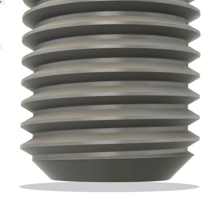

Hi All.
I just started playing threads and 3D printing -- so cool!
I think I mad a mistake, but am looking for confirmation / insight.
I did a chamfer on a cylinder (screw) before applying the thread.
Printed out the male and female components, and there is no way they would thread.
Looking at my design in x-ray, I think it's the chamfer that's preventing the thread to enter. The angle looks wrong.
Can anyone confirm my mistake?
Should I avoid a chamfer, or just make sure it's at the same angle as the thread?
Thanks  🙂

What you need to do is add the chamfer after the thread feature. However, there's a little trick to getting it to work! When you first add your thread feature make sure it's just a cosmetic thread (make sure 'modeled' is unchecked). Then add the chamfer. Once you've done this go back and edit the thread feature and now check the 'modeled' checkbox. You should now have a modelled thread with a chamfer.

There is another way to add the chamfer to a threaded feature that might be a click or two less.   What I started doing is model the thread before I put on any chamfers.   So I model the thread then before doing any chamfers I right click on the thread feature in the timeline and suppress feature..  After suppressing this feature you can now add your chamfers.  Now un-suppress this feature and your threads will cut into the chamfer as it is supposed to.
