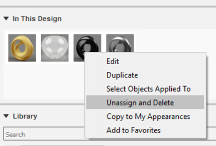

daniil_timin1
Right click on material --> "Unassign and delete", see pic
