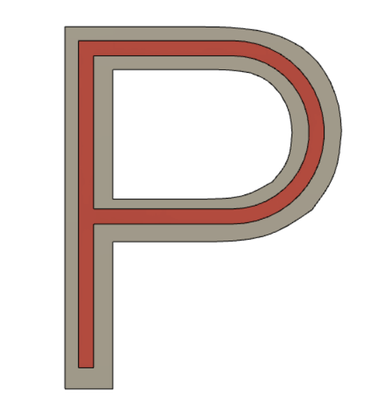

Hi, Im trying to design letters with specific dimension hollowed inside. Tried to use the shell function but this only measure the thickness of the shell, so is there function like shell but in reverse? when you enter the thickness the inside or hollowed part will be the value you entered.

Hi here is the f3d file, the letter P on the left is the one I want, 5mm channel inside the letter. I was able to do this using illustrator then Fusion360 however sketching it takes a lot of time. I need to do this in all letters.

Given the inconsistent widths and crudely formed splines, you will need to sketch each individual letter:
The only other option is to create 5mm wide characters in the other app, then create the outer part by  projecting the character to a sketch then offsetting the profiles.
p.s. You can also use a sweep.  Draw the centerline of the character as the path.  The path cannot self intersect.
