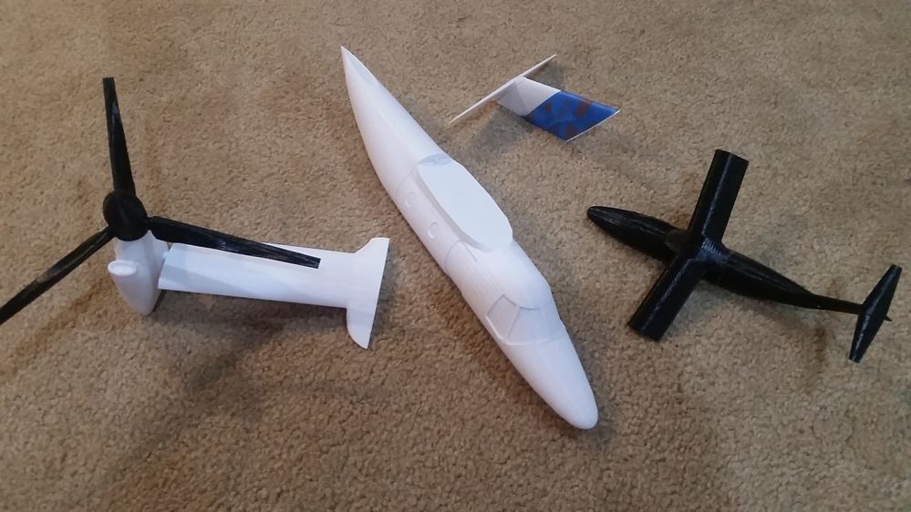

I am trying to make a 3D printable tiltrotor from surfaces.  I have watched many how to videos which have gotten me to a very good point where I have stitched surfaces together and patched up holes.  It will be printed in sections.  But I am stumped with the complex geometry of a faring at the tip of the wing.  It is the juncture between the wing and engine nacelle that covers the actuators that move the nacelle.  I am trying to make it solid so that I can put a hole in the end for a post that the engine nacelle will rotate about.
Picture 1 shows a good part of the aircraft left side.
Picture 2 - 4 show various views of the wing and fairing without the engine nacelle
Picture 5 shows just the engine nacelle with the post that will insert into the wing (once I figure this out).

stdubeck
Here are the remaining pictures.
Any suggestions would be welcome.
I have tried the following;
The fairing is too complex for "thicken" to work.
Too many sharp edges for patching the open border.
You can see in picture 3 and 4 that the trailing edge of the fairing does not align with each other, and picture 6 shows just the faring.  Note picture 6 is the right faring.  I already stitched the left faring (in the other pictures) to the wing so I could not hide the wing.
I would like a solid wing including the faring filled in with a hole for the post that is on the nacelle in picture 5.
