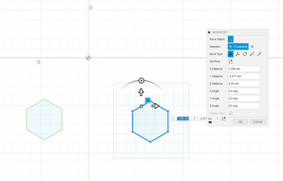

I've added the file. Now this is just an example, but I'm more interested in the principle, rather than this particular drawing.
So I started by importing a Square.svg (why, that's not the point, because next time it may be in the shape of rabbit silhouette, but if it doesn't work with a square, a more advanced silhouette svg is not likely to work neither). I then did some extrudes and a loft into a hexagon, also from a svg, attached inside the file,
Now lets say I didn't want to use the first square.svg. I instead wanted to start the drawing with the hexagon.svg and then do the exact same extrudes, lofts etc. It would save a lot of time if the first svg, could be replace with a second svg, and then every other parameter is intact. Of course I understand, it could render unexpected results sometimes, but is it doable?
Or copy the timeline from step 2 and onwards and paste it on another svg as a new starting point?
I hope you understand what I'm looking for. I tried to replace the svg but couldn't find out how to, and also tried to delete and replace the the first step in the timeline but only got a lot of errors 🙂

Here is what I would do.
First take Use2replaceintitialsquare Sketch (hexagon) after Sketch1.
Then, within Use2replaceintitialsquare Sketch, copy and paste it to the appropriate location.
Modify extrude1 from hexagonal.
It was changed to this form.
After that, you can change the dimensions to whatever dimensions you want.
Here is a video, for your reference.
https://knowledge.autodesk.com/community/screencast/6a48fc95-8f28-4f56-8d1a-b2f210189cb8

Thank you, this was exactly what I was looking for. It was really helpful description and the video was great.
