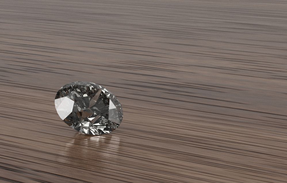

I have done this both ways and there do seem to be some differences.
jasonhomrighaus
So i decided to play with the a little.
the first image i made using a solid body of air with the table and diamond inside it
the second is just the table and the diamond
the third is an air body that has had the diamond and table cut out of it to create three non interfering bodies
With solid air massWith solid air massWith no air massWith no air massWith cutout air massWith cutout air mass
Now this is interesting, because I see some odd or unexpected effects when shining light through two materials that interface but have different refractive indices, and those effects are a bit like what I see in your last image with the air body; these lines and breaks appear.
