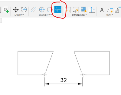

I do not want to show fillet edge in my drawing as it messes up with the dimensions instead will mark up the edges where fillet needs to be, with a Leader Note, but want to show it in the 3D file, which I will share with the CNC guy.
How can I do this?
Dimension highlighted in yellow needs to be 32mm but because of the fillet it became 32.71mm. I want the machinist to know that it needs to be 32mm and then do the round edge. But Because of the fillet edge displayed here, I am not being able to.
Is there any solution for this?

Hi! You may want to leverage Configuration workflow. Basically, you need two Configuration members, one with fillets computed and the other one with fillets suppressed. The latter is for documentation purpose.

you could use edge extension tool in drawings-
