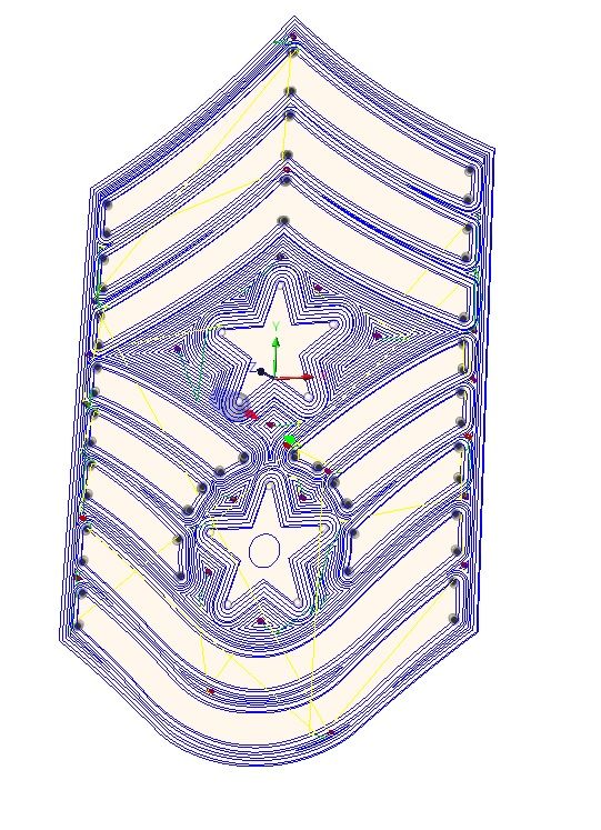

What is the best way to radius all points to 0.065"?  Now, what is the easiest way to radius all points to 0.065"?  They aren't always the same solution...
I have been doing them with 3-Point arc but that's more a guess.  After I draw it then I have to see if I actually got it right and if not then I delete it and try again - painstaking long process.
For this application I can't use filet so I need to draw in the radius.  I only circled a few but I need to radius all points.  I've attached the file if that will help.

Thanks, guys.  What I mean by best and easiest not always being the same is best defined by a couple of illustrations:
1) I want a nice, hand rubbed, French polish shellac finish on a piece of furniture or guitar but I don't want to go through all the labor and time to do it that way.  So I grab a can of spray Shellac and spray that on and then do a little rubbing so it doesn't look like it came out of a rattle can.  The hand rubbed and labor intensive French polish finish is the best way to achieve that look but it isn't the easiest.  The rattle can is the easiest but it won't look as good.
2) I need to rip a board for a piece of furniture and am shooting for a hand-built piece.  So I decide to grab a rip saw and cut the board by hand.  15 minutes later I have a board with a mediocre cut that now needs to be straightened up with a plane.  Or I can cut it in 5 seconds on the table saw and have a perfectly straight line and still claim hand-built for the rest of the piece.  The table saw is both the easiest and best way to do this cut.
So... on to the reason I don't want to use fillet (and yes, I see I mistyped it in my original post - sorry).  The pieces off to the right are derived from the pockets in the main board by using offset, reducing the size by 0.0075" and then extruding out to 0.150" to become inserts for the pockets.  The main board is Walnut and the inserts are Maple.
Because I can't cut square inside corners with a round bit I need to radius everything for a drop in fit.  I'll be cutting these with a 1/8" bit, hence the need for a radius of about 0.065".  So I figured if my drawing had the radius in it and I used offset to create the inserts then everything would fit.  If I use fillet for the pockets, which is easily done, then my inserts will still have sharp corners and points if I create them by using offset.
So maybe I should be asking if there's a way to create a new body after the fillet is applied so that the insert will match and drop in the pocket.  Is that doable?
Either way I need to be able to do these so the inserts fit with minimal tweaking.  If I was going to make just one of these I would just leave the inside corners and points as the 1/8" bit left them and clean them up by hand to fit the inserts.  But I'll be making several of these and don't want to do that much hand work.  It'll take too long and my back and eyes would complain!  LOL!
Hope this helps - thanks again!

The quickest way will be to model size for size and offset in the machining op in the CAM workspace. You might even make the inserts as a single part to make selection easier. Also you could make them as a single block glue in place then machine away after.
Screencast should give you an idea of what I mean. As I've used a combine cut after creating the pockets and fillets the inserts will always match.

The pockets don't need to be modeled for 2D machining.
It's a simple operation to fillet the geometry in the sketch, then create the CAM toolpaths:
Instead of using the Contour toolpath for the inserts, a Pocket would be easier.

I would very much use the approach that @HughesTooling showed. I wouldn't have thought of @etfrench's pocketing idea, but it's cool, too.
In terms of 'easiest'/'best', personally I would say key points include:
  • I'd definitely cut both parts off the same geometry. i.e. don't copy a second sketch off to the side. Too many chances to introduce error.
  • Building on that, the 'combine/subtract' method pretty much guarantees that you haven't missed a selection anywhere. The solids will match.
  • selecting all the vertical edges using Marks' method ensures that both the male and female parts will be properly filleted.
  • when we work with imported sketches like this, we try to leave the sketch well enough alone.... filleting in the sketch it's too easy to accidentally move something, and too much work to ground/project/retrace. Turn it into a solid fast, and work from there, IMO
  • as Mark offered.... standard best practice in our shop would be to model for size, machine to fit. i.e. model both contours the same , then use 'Stock to Leave' in CAM to control how precise the fit is. The only time we'd actually model in clearance is when it's actually required for functional reasons.

I didn't see the post by @etfrench until today and the others are, I'm afraid, a bit beyond my understanding of the program.  Some of the videos wouldn't go full screen and I can't quite tell what's happening.  Some parts of each make sense to me but some don't and since I needed to get the plaque finished and out to the customer I did it the hard way - manually radiused each point.  And yes, it took a while.  And the inserts didn't fit without some hand work.  They were close but not a drop-in by any means.
So fast forward to today and I have another order for a slightly different plaque but basically the same.  Instead of a Command Chief this one will be an SFC Stripe (I wasn't in the Air Force so no idea what either is...).  This one doesn't have the stars and is slightly smaller.
But I saw the post by @etfrench and radiused every point to 0.65" in a matter of about two minutes where the other one took hours.
I still need to work on the inserts but I may try a test with cutting the inserts with Pocket instead of Contour.
