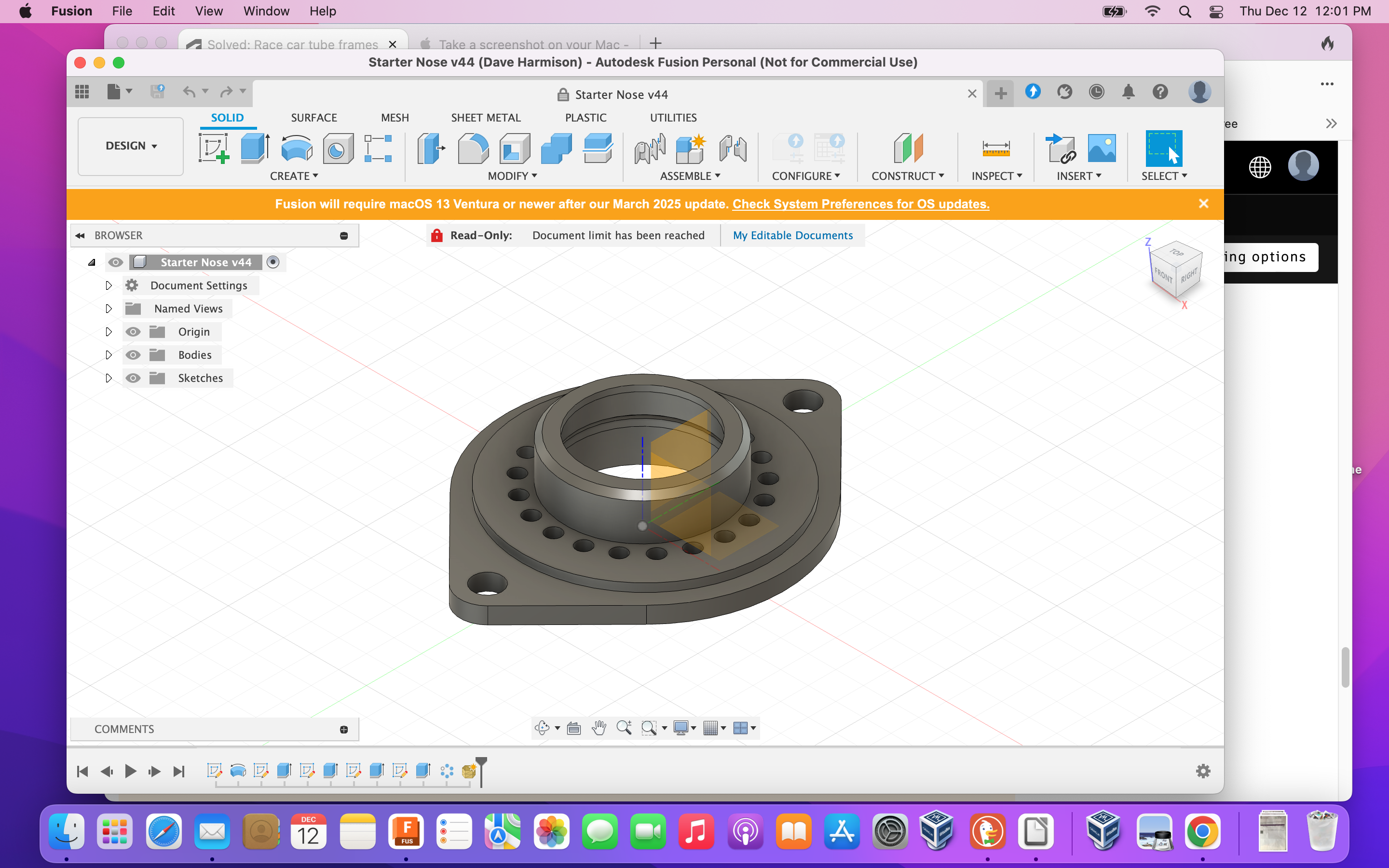

Here’s my first Fusion project. It’s a starter nose for the same racecar. I CNC’d a model on my 3D router to check the fit.
What is unique about it is that the motor itself is offset from where you’d think the centerline of the starter is. That’s because it’s to put a Japanese starter on a British car.

I don’t understand the 2nd pic relevance, yes Fusion is good for those parts, but needs specialised handling of pipes in this style chassis, as you are finding out.
