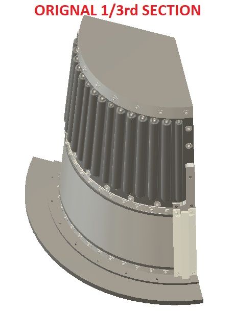

I've got a Component that constitutes 1/3rd of a section of my model.
I used the Circular Pattern operation to create an identical copy of the Component 120 degrees around the common axis.
In both the original and the duplicate all the sub-components and bodies are properly positioned.
When I use the "Save As STL" option on the original component it generates the Mesh properly.
But when I use "Save As STL" on the duplicate Component it messes up. All of the bolts and the vertical covers are misplaced by what seems to be an additional 120 degrees around the axis.
I also have an additional Copy of the original Component which I created using a Copy/PasteNEW operation and then made significant modifications to it.
When I go to do a "Save as STL" for that Copy/PastedNEW version is CORRECTLY generates the mesh without any weirdly positioned bolts and covers..
It seems that there's something wrong with copies made using the Circular Pattern tool, in that it goofs up when trying to create the STL mesh. I had also tried deleting that copy that was made by the Circular Pattern tool and simply did a Copy/Paste (not "NEW"). And that copy had the same mesh-making errors.

The ERROR that I had encountered, and initially reported, occurred when I have those components WITHIN my (very large) overall model. Separating that single One-Third component out as a totally separate project results in the Circular Pattern and Save As STL WORKING !!!
I am totally confused.

I agree this looks buggy.  I suspect part of the issue is the structure of your components, and the fact that the majority of your components aren't locked down with some type of joint.  (although honestly, it seems like it should export what you see on the screen regardless, which is why I think it's buggy)
I took your original attachment and added  rigid group to each of the 2 top level assemblies before doing the pattern.  This seems to make the stl export function as expected.  try it out and see if that is the case for you.
The other issue is that you have bodies and components residing at the same hierarchy level.  The has been some debate about this practice on this forum, but this is generally considered a bad practice.  Seen a couple of weird happenings that were hard to understand that resulted directly from this practice.  Don't know if that is also at play here.

So, yeah, the Save As STL seems to be happy with objects that are RIGID JOINTed but NOT with objects that are Circular Patterned, even when the first one of the pattern is itself Rigid Joined.

So, BOTTOM LINE. It seems that "Save As STL" does not assure that everything is positioned as it appears in the model.
It does appear that making sure that all sub-components are explicitly JOINT-ed to the main component is necessary. However, from other tests (see prior comments) it appears that it also sometimes fails on components that are duplicated via Circular Pattern, even when the source component for the pattern is itself RIGIDly JOINTed.

As suggested to me in this thread I applied some Rigid Joints on some of the sub-components, and it worked. It eliminated the spurious rotation of those sub-components. The sub-components that I Rigidly Jointed now no longer get rotated off of the parent component that I'm trying to Save As STL.
For the first test I did two Rigid Joints, one between the main Body and the Parachute Cable Cover, and the other between the main Body and the Parachute Cable Connector. I did those joints on the original one-third section. And when I went ahead to do the Save As STL on the DUPLICATED (via the Circular Pattern tool) one-third section, those two, now-rigidly connected parts, stayed exactly where they should be. There was no spurious rotations.
That left all of the bolts and washers, about fifty of them, still improperly totating. I thought, well, fortunately I had organized all those bolts and washers beneath a parent Component, so they're all sub-components. So I tried to do a Rigid Joint between the main Body and that (parent) Bolts and Washers component, figuring that if that parent component is Rigidly Jointed then all the sub-components will follow right along and NOT get spuriously rotated.
But NOPE. It didn't work. When I went to do the Save As STL on the duplicated one-third section all those bolts and washers STILL got rotated off of the main body.
It seems that I have to do a Rigid Joint, INDIVIDUALLY for EACH AND EVERY Bolt and Washer!!!!!
There's something like FIFTY of them on this section of my model. But overall, on the entire model, there are HUNDREDS of bolts/washers that are positioned using the Circular Pattern tool, each such pattern referencing an existing bolt/washer that IS Rigidly Jointed. But it apparently doesn't matter, as the Save As STL function appears to insist that each and every one of them ALSO be individually Rigidly Jointed.
So, there is a SERIOUS ERROR in how Fusion 360 handles the Save As STL function.

Yes, doing a Rigid Group on that Component would indeed get around the problem with the Component that I was having trouble doing the Save As STL operation on.
The approach that I finally took was this: The Component that I was having trouble with was created by using the Circular Pattern operation, and it was that operation that was causing the weird results I was encountering when doing the Save As STL operation. I was NOT encountering the weird results on a different Component (based off of the same original component) but which I created using the Copy/Paste New operation. So I DELETED the one that was made via the Circular Pattern operation and instead created it with another Copy/Paste New operation. Just as with doing a Rigid Group, this change in how I created the second copy eliminates the weirdness with Save As STL.
So, yes, there are at least a couple of approaches that get around the problem.
But the core problem is not resolved by "getting around it". That is clearly an error in how Save As STL works. And it's not really a problem with failing to lock down all the Components, since a component made using Copy/PasteNEW works fine in the Save As STL even though not all components are locked down. Save As STL seems to be picking up the rotation value that was used to originally position the overall Component, back when the Circular Pattern operation was performed, and applying it AGAIN to each of the non-Jointed components before performing the meshing operation on them.
