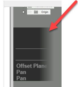

So Guenther, not only is this a bug with regards to the Canvases folder, but it's also apparently a bug with the Construction folder as well. In the attached screen capture, I was attempting to create an offset plane, the first such Construction object in this project file. As you can see, there is no Construction folder yet appearing in the browser. When I try to create the offset plane, I get a warning in the lower right that indicates the object I'm trying to create is not visible. Well not only is it not visible, but the Construction folder is not even automatically created without me first clicking OK. Then when I do click OK, I have to make the invisible (by default) Construction folder visible in order to see the offset plane I just created. Why should I have to do that? If I'm trying to create an offset plane, shouldn't it be automatically visible in an automatically-created visible Construction folder when I click OK? Why the extra step?

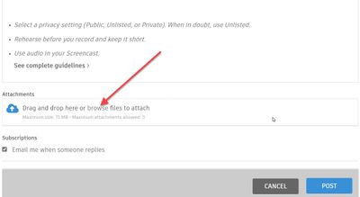

You can see in my Screencast that what you describe as a "Bug" does not happen.  What the forum needs is for you to record a Screencast or some other video showing you starting with a new model file and the actual creation of an offset work plane.  After completing the Screencast, save the file and attach it to a reply to your forum question along with the video.  This will give the forum users both visual record and a file to verify what is happening.  If you do not know how to attach your model, open it in Fusion360, select the File menu and then choose Export and save the .F3D file to your hard drive. Then use the Attachments section of a reply forum post to attach it.
If this panel gets in your way of viewing the Screencast, click on the area indicated to close it.

@F360uzr, I downloaded your supplied model and reviewed your Screencast and I can verify your issue "in this model".   I still do not and have not seen this issue with any model I have created using my Fusion 360 installation.
@jeff_strater,  @Phil.E , when either of you have a chance, please look at the attached model from @F360uzr and try and create a new Construction plane.  The issue is not that is is created, the issue is the Construction folder appears in the Browser in a Hidden state.  Thank you.
