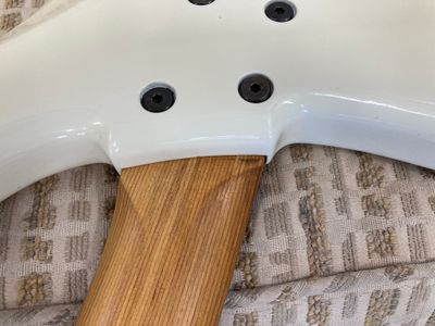

I've been having a lot of trouble with the shaping I want to do, but the example that caused me to dig in and troubleshoot was trying to achieve a result like like this:
