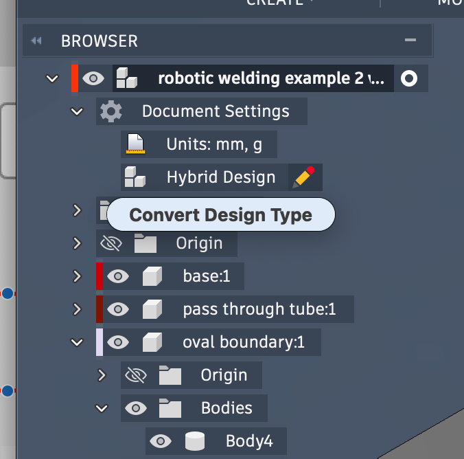

I primarily use fusion 360 for cabinet making and woodworking. I am wanting to put multiple components under one component in the browser tree like I have always done, but it is not working now that I am on the 2026 version. I have the marker at the far end of my design history. Has the feature where you can drag drop multiple components into one component been done away with in this new version or am I just missing something?

are you in Hybrid, Part, or Assembly mode?  If you are in Hybrid, everything should work the same.  I cannot speak for Assembly mode (I don't use it), and obviously, this is not available in Part mode (no components)

I'm in hybrid mode, so that's why I'm so frustrated that it's not working like it used to.

The solution that you suggested didn't work for me, but that did lead me to discover a/the solution. I was always making the new component under which I wanted to add additional components as an assembly and that automatically made it external. I just needed to make the new component a part and that left a check box where I could select whether it was external or not. With it being an internal part, now I'm able to add other parts to it in the browser tree.
