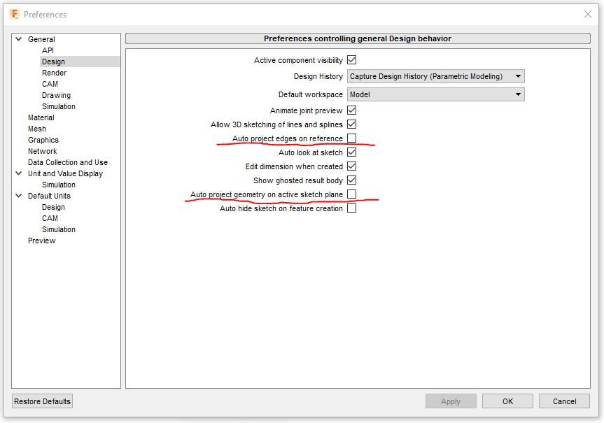

There are 2 separate Preferences, that involve Projections,
sounds like you have got the project on sketch creation still turned on.
Not new, some of us just don’t turn either on, and User select when to Project.
Might help....
Message 5 of 11
hectorkal
Do you mean those 2?
Message 6 of 11
davebYYPCU
Yes, if turned on, they are what I though was happening.

hectorkal
Yes, but i already turned them off, and this is still happening!
Message 8 of 11
chrisplyler
There are TWO settings for auto-projection.
The second one projects the whole face when you make a new sketch on that face.
The FIRST one is what is happening in your picture. You started a new sketch on the upper face of the extrusion. Then you drew a rectangle. While drawing the rectangle, you clicked very close to (or on) the edge of the extrusion, and Fusion assumed you were trying to reference that edge, so it auto-projected that edge into your new sketch.
