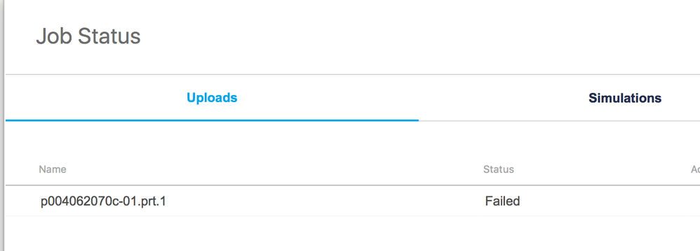

ec2638
Failing to upload Creo 4 .prt and .asm.  Even a single .prt fails. Creo 3 and 2 works.

ec2638
Bump...Fusion still fails to import Creo 4 .prt files.
Creo 3 works...

@ec2638 I just want to let you know that I was able to confirm that Creo 4.0 file format is not currently supported. I'm working on an update for this other thread.
https://forums.autodesk.com/t5/fusion-360-design-validate/data-exchange-in-fusion-360-build-2-0-1291...
