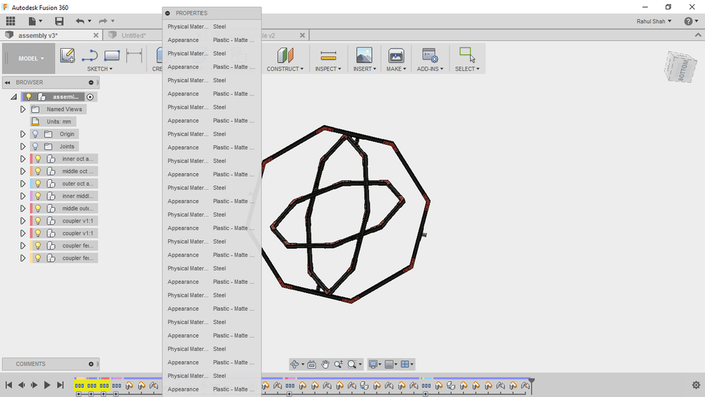

property console
can anyone help me to close this property console.
i tried to scroll down, move the console up. but i cannot find the cancel button.
and  how to calculate the total mass and volume of the assembly.?

HughesTooling
Try grabbing the top of the dialog, the title bar and drag it to the right side of the screen, when the mouse pointer get to the edge of the Fusion screen you should see a green vertical line. Release the mouse button and the dialog should dock and resize.
