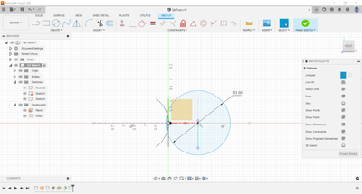

Thanks, yes just checked myself, the origin planes can be projected. It is very handy in constraining new curves/entities in the sketch. In below example, I was able to have reference of curve of projected plane to constrain the center of the right circle at the time I drew it. However, for the left circle, I didn't have any reference so its center remained unconstrained, and thus i have to constrain it as horizontal to origin as an additional step. Turning on grid doesn't automatically do this, unless I enable snap to grid, which I don't prefer.

I was trying to demonstrate how projecting an intersecting (perpendicular) principal plane would be useful for quick reference and constraining. Yes unfortunately Fusion 360 projects a very small portion of the plane unlike Inventor, which automatically gages the overall sketch size and produces a line encompassing the whole sketch, which is what I wanted to achieve.

I have the same scenario. I want to constrain a circle vertically to the horizontal plane, but nothing seems to make it "stick". I have projected the plane and drawn a horizontal line as you suggest--which appears to be constrained, but cannot get the circle to constrain to the horizontal.

I am trying to routinely "stick" circles to the horizontal plane as indicated below. I don't really know how I got the big circle to constrain, but I'm assuming it is because I projected the X-axis onto the sketch and then drew a construction line and made them all colinear.
But how do I extend those constraints to the other side of the vertical plane? Nothing seems to work.

I am havving this same problem, except the Horiz constraint is not working for the left circle.
in addition, I am trying to "stick" a sketch point at the intersection of the big circle and the horizontal plane in order to accurately dimension to the tangent. The Pick Tangent doesnt seem to work either.

Start a sketch and hide the Origin planes, you will see a sketch Origin point.  Constrain to this point.  To stick to the x direction, use horizontal to this point.
Projecting the X plane, gives a purple short line that can not be altered unless you beak the link, so why bother, just draw your own horizontal line and it can be any length, and side you need.  You probably snagged the mid point of the projected line to constrain that circle.
Small circle, constrain horizontal with centre point, and sketch origin.
Pick Tangent is awkward in Fusion, Dimension > Select circle, right click, select pick Tangent, then select second circle right click, select Pick Tangent, and set distance.
Sketch points on circles for just Dimension, is clutter, and not required, the way Fusion works.
