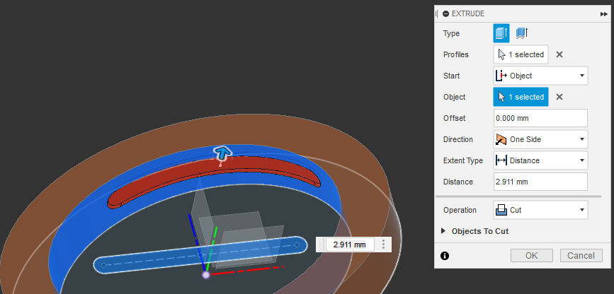

I have searched this forum and managed to get this far but now stuck on how to proceed. I projected slot sketch to surface but isnt a profile to perform an extrude on? The projected lines of the curved slot on the face are now control point splines? See picture: Arc_Cut_Slot.jpg
1. Faces of project
2. Slot Profile
Results are as expected the purple sketch object on the faces.
So question is how can on now extrude this into a cut feature? It is not a profile tried making point coincident but get error that it is over constrained.
I cannot use the extrude slot from surface as the slot on the ends cuts all the way through.
TIA!
Rick...

If you want Extrude then you don't need to project. Just set the start to Object and select the surface to extrude from.
Mark Hughes

Reading your post again I think you want a pocket so as above but into the body.

rickjohnston
Thanks @HughesTooling I tried that my results do not apply the curve and just simply a straight cut like so:
It does however seem to be applied to your face selected or am I not seeing the model correctly?

HughesTooling
@rickjohnston  Can you share the design? Export as an f3d and attach. If not can you get a screenshot showing the extrude dialog and more of the part. Only thing that stands out is there's a seam in the middle of the area where you want the slot, not sure if that might cause a problem.

rickjohnston
Thanks again everyone. I just now noticed somehow that inside face has been split (just as @HughesTooling noticed) and I will need to investigate how it happened and/or recreate the model.

Split Face is not needed.
You can Extrude to offset of the cylindrical face.
