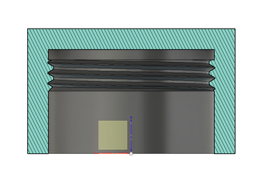

Chamfer the top, then edit the thread feature and change it to Modeled:
In order to make the top fit to the bottom of the thread, this area needs to have a relief cut which would be easiest to do in the original sketch.

The top starts the same as the bottom and uses the same Origin.  This time I added the relief for the threads😁
Since both top and bottom were modeled in place, an As Built joint can be used.

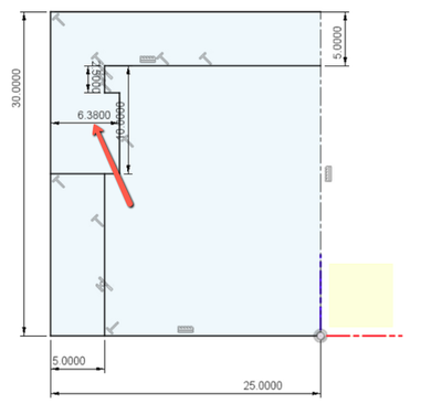

@TheCADWhisperer @etfrench  Getting closer!  Thank you for all of your help thus far.  I started fresh making sure not to move anything away from it's origin and keeping my components organized.  To get the holes, I drew both components, joined them, and put holes through both at the same time (using a circular pattern to repeat the remaining holes).
@etfrench how did you determine this dimension in the cap? I made the inner housing visible, zoomed in and placed the line's point close to but not touching the threads.  Was that right?
Also, How did you make the 'relief cut'?  When I go back to the sketch, I can't tell where to place the notch because the threads aren't visible.
Message 11 of 11
etfrench
When you apply the threads, Fusion 360 changes the original diameter to the minor or major diameter of the thread (depending on inside or outside threads), so that dimension can be anything.
Place the relief using the dimensions you set for the thread.  In your previous file, that was 10mm from the top of the bottom.
