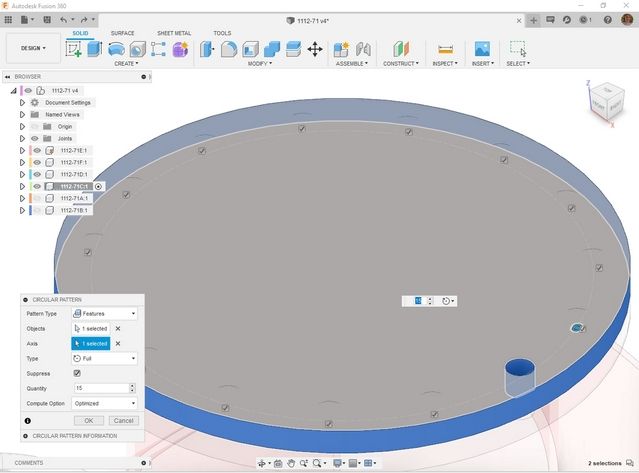

I am trying to make feature patterns (rectangular and circular) and everything is working correctly, but the preview of the result is not rendered correctly. Is there a problem with this or is it that Fusion 360 does it like this?

Hi @Francisco_García. The pattern previews seem to work in the default "Steel-Satin" appearance. Try adding that appearance to the object.

@dikshant. It is true. With the initial appearance, the operation preview looks good, but the same does not happen with the other appearances. That is frustrating.
