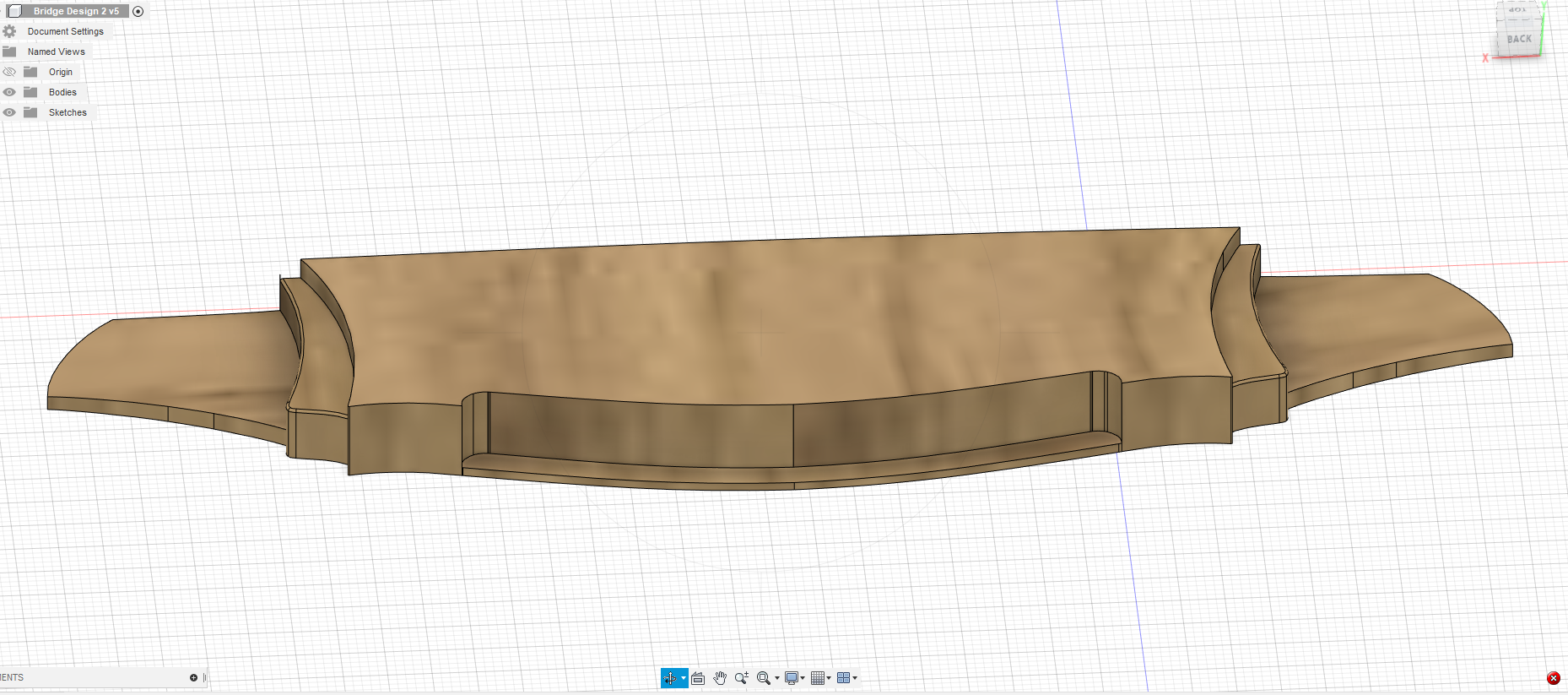

cmstewart21
I am designing a guitar bridge (for acoustic guitar) and on the back of it, there is a carved out strip for the strings to enter (a string-thru bridge design). I am calling this the 'deck', and I want the floor of it and the walls around to have a fillet -- just a curve instead of a corner as the transition upward.
When I use the fillet tool, it won't work across the whole deck. At the moment I can't get any of it to work with the fillet tool. I have attached screenshots of it, in case that helps. I don't yet know how to attach the file (I am new to F360 and I am using the 'Not For Commercial Use' version).
Please let me know if there's anything you think I could do that might help. This is one of the last steps to finishing this, and it would be a huge help. I have uploaded the photos to this post (I didn't know how to embed them, sorry).

stiller.design
you better post the 3d model so we can figure out the issue.
from my guess its a not very clean sketch line/curve that cause the issue. I recommend to retrace the sketch using the sketch tools rather then relying on the SVG geometry

laughingcreek
to attach a model, export  it as a .f3d file and attach at bottom of a post.
svg's are notoriously problematic in fusion.  my guess is that your's contains "near tangent" conditions between sketch segments, which is causing the fillet to fail.

cmstewart21
Thanks for the tips. This started as a hand-drawing, then I scanned it, then traced it in Affinity designer, edited it in Corel Draw, and now I've 3D-ized it in Fusion. So, I'm really not an expert in any of that, and re-drawing it in Fusion sounds dauting (since I'm already really happy with the shape, and would hate to screw it up).
I don't really know the solution if there are "near tangent" segments (or how to recognize that). I know there are a number of different segments along the curve though (there had to be, to get this to plot correctly as a vector). This is all new to me. The error I'm getting is: "Error: The fillet/chamfer could not be created at the requested size. This might be occurring at the ends of the selected edges. Try adjusting the size or using multiple separate operations. Check that the selected edge chain ends at a sensible position, and if not try selecting more edges."
I've attached the f3d file, so you can view it. Thanks for taking the time to help!

wmhazzard
The curvature comb analysis shows just how bad the shape is, I don't think I have ever seen one so bad. All of the edges are near tangent since when starting the fillet tool you have to select every edge by itself, even with the tangent edges option turned on. You don't have a sketch to work with now since you created a base feature so the only way to fix this will be to modify what you have or start over. I would start over but if a slight dimension change is OK, a little material can be cut away to fix the curve so it can be filleted.
If you have tangent constraints in your sketch between arcs and lines, you will most likely have a successful fillet.
Also all of those moves are bad practice. Get into the habit of creating components and bodies in their intended positions and referenced to the origin.
See the attached model.

g-andresen
As long as the quality of the base sketch is poor, you will have problems with the following actions as well.
Even if you could edit imported sketches in Fusion afterwards (with great effort and appropriate experience), it is better to create them right here in the form of constrained contours.

wmhazzard
Working in Fusion the way that you are will just make using the program much harder than it would be if you work the ay the program was intended to work.
I would stop what you are doing and start watching beginner Youtube videos to get the basics down and create everything that you need directly in Fusion. Outside graphics programs rarely work well inside Fusion.
On the protruding part, you may be able to select the faces by holding ctrl and left clicking on the faces and hitting delete but it would be better to model where things like that don't happen.
In order to modify the sketch that I created, you need to edit the sketch, select the fix/unfix tool and unfix the green points which will allow you to move the curves.
