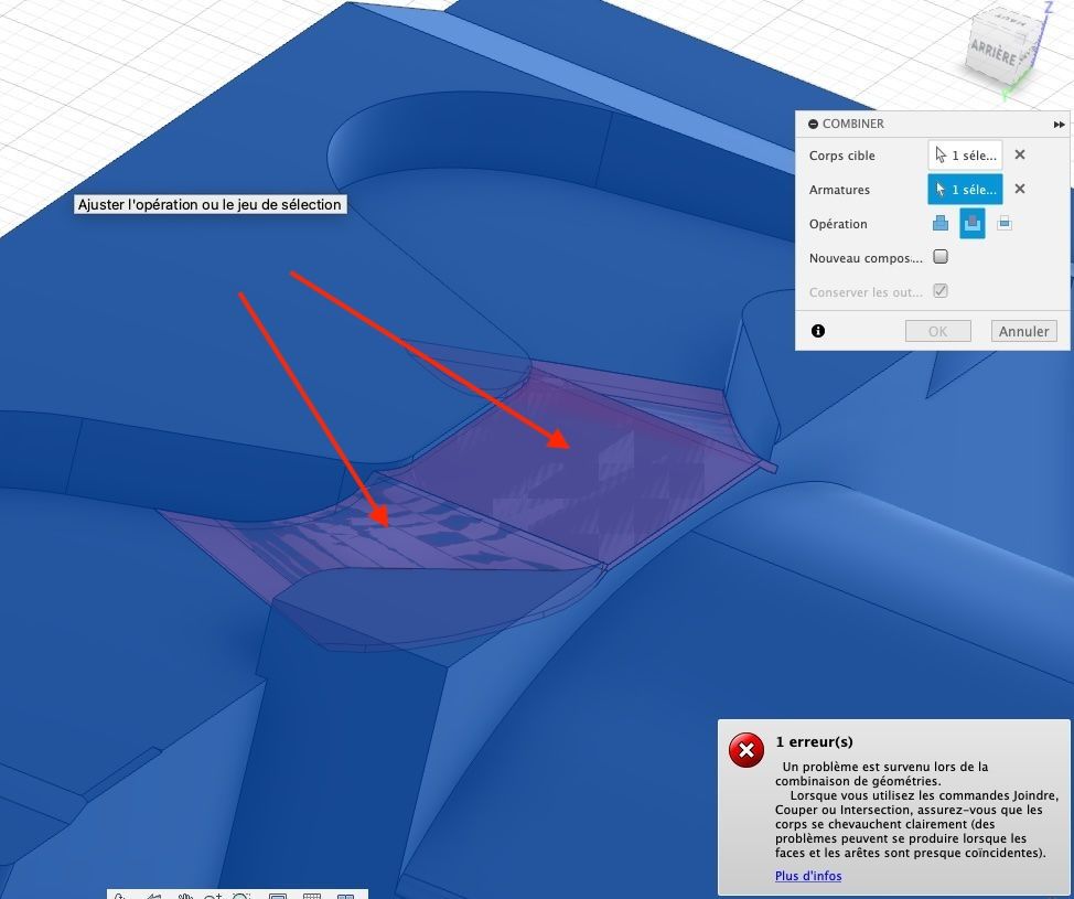

Hy everyone,
I'm trying to use boolean tools for bodies in F360 in order to remove the place of a body on the top of another one.
As shown bellow, the red body is inside the big one and I try to get an intersection or to cut the biggest. My problem is that F360 doesn't want to do it, it says that I have to be sure that both bodies intersect each other. And I'm sure about that.
Would you have solutions please ?
I san't easily redefine that little body because it is extracted from another body that will fit on the big one, and I need clearance between both to be sure to be able to mount it.
Thank you for your help !

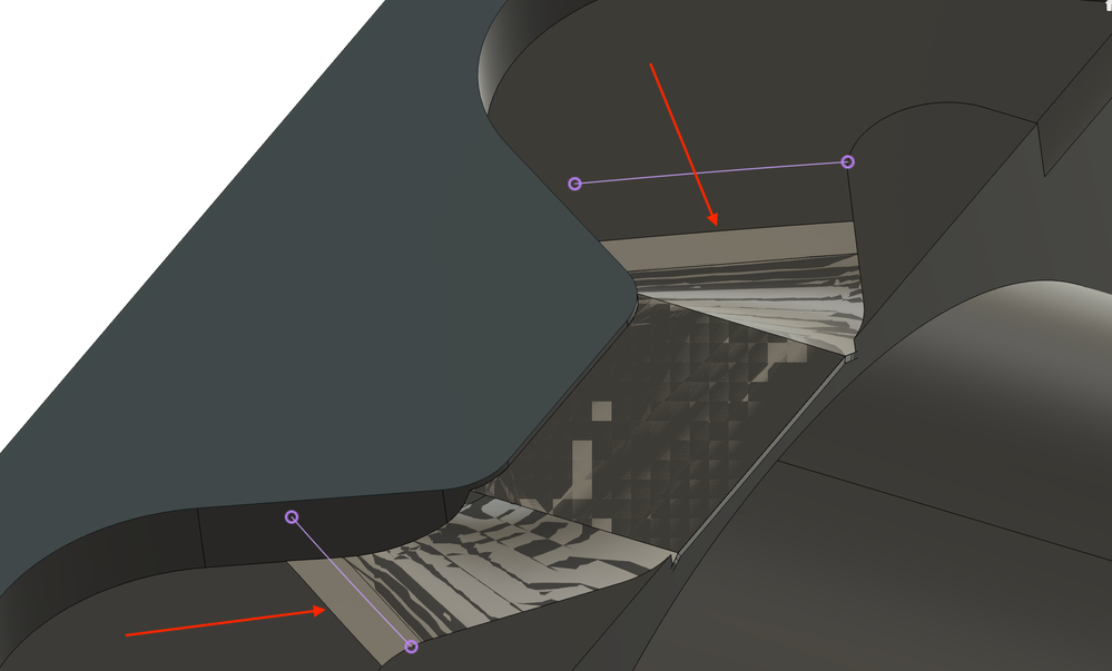

Message 4 of 13
jeff_strater
I have not looked at your design (and don't have time tonight), but I have a good idea of what the problem is.  Combine will often fail if the bodies involved have nearly coincident geometry.  These areas appear to have that condition (you can tell by the splotchy appearance).

Message 5 of 13
simon.doussetCDVPT
Thank you Jeff for your suggestion. I've tried it and I do have the very same problem.
As you can see on the attached picture, I pulled the upper face to be sure to have à right crossing of bodies. The fact is that when I use the pulling function, F360 doesn't want me to use it on the 3 faces of that little body, I can't understand why. Would you have an idea ?
Thank you !

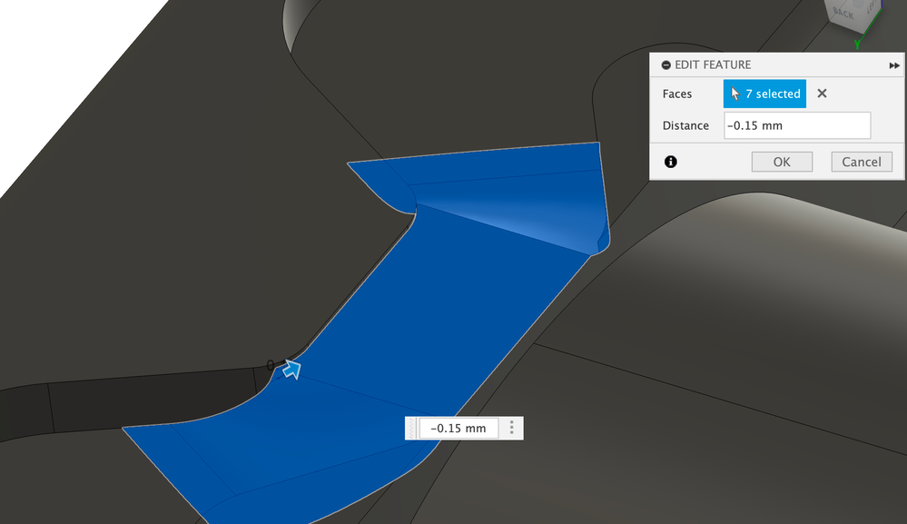

If what you are trying to do is to cut a .15mm depression in the top of the body, here is one way to do it, that does not rely on exact matching geometry.  First, create a sketch on the top face, and project the end edges of the Cage_spd_2 body:
Then, use those two lines to split the faces of the main body:
then, use Offset Faces to push down these faces:
resulting in this geometry:
which I think is close to what you are after.  At the very least, it should give you some ideas of how to proceed...

Message 9 of 13
TrippyLighting
@simon.doussetCDVPT wrote:
But I still don't understand why my first method doesn't work. Anyone would have an idea ?
Yep. It's a near-coincidence problem due to hackish, imprecise modeling techniques!
